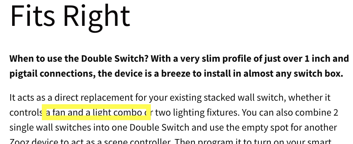

I appreciate the thoughtful response and the various options presented. The two switches are for a ceiling light/fan combination. The Zen30 disclaims such use. Relays may be an option; still researching.

They actually explicitly recognize this use:
If you're seeing information that sounds like this in discussion of the product, it's probably noting that you won't get speed control of the fan, which is true -- just on/off, but with your existing wall switch (and any option that fits more than this in a single gang), that's probably all you're getting, too.
Interesting. This is what I saw on the Zin30 Spec page, " Maximum Load: 75 W LED, 250 W incandescent (don't use with tube lights, chandeliers, switched receptacles, or fans) - See more about the load." (emphasis is mine) I stopped digging at that point. However, there are some additional linked pages talking various use cases. And, yes, I see what you are saying talked about there.
I'll dig deeper. This may indeed be the right device. Thanks.
Cautious optimism, then for this device. The Zen30 may be the right fit for my need right now. However, I remain interested in progress for Hubitat Matter support. Perhaps one day my front door lock will be supported. Thanks.
That's for the "top" part of the switch; the small bottom relay notes that it can take up to 1/2 HP motors, which is generally suitable for most residential ceiling fans, though, of course, you'd want to verify the specs yourself.
If you want to replace the switch, possibly; but keep in mind the other options that can work behind your existing switches (or perhaps at the load) and provide similar functionality without changing the way anything looks.
