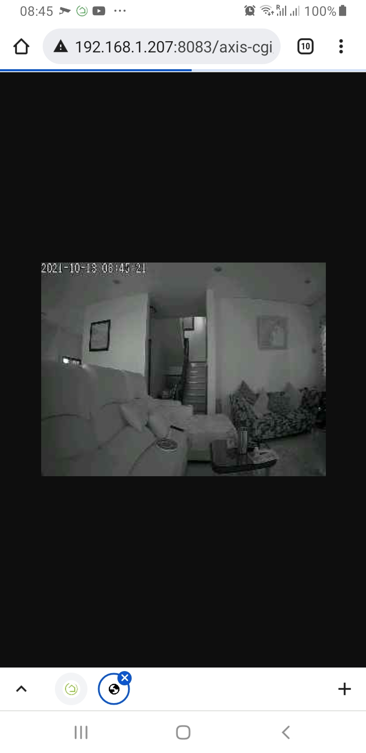

You can also test the url in any browser. Once you've got that url formatted correctly it will display the webcam in the browser, served out by your tinyCam webserver. It will look something like this (note you can also change the numbers for the resolution in the url too ok, to suit what image quality/size you want) ...
Using a browser first is a good way to test your url because if the password is incorrect tinyCam will request you to enter your username and password. Then it will display as per the image above.
