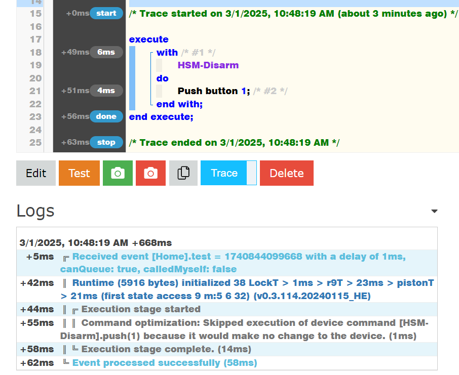

I am having this exact problem even today. Webcore is ignoring the push button HSM-Disarm, causing all sorts of problems.
Would need to see a green snapshot of your reproducer piston. If it is large, if possible make a small piston that shows the problem.
My comment "causing all sorts of problem" is a statement of pistons which should be disarming the HSM are not, so therefore, other pistons are reacting to intruder detection upon arrival.
But the core (no pun) problem is that push buttons without setting the entire piston's command optimization to disabled will fail to "push the button" if it was previously performed. However, if one manually adds the "release" command before push, it will behave as expected.

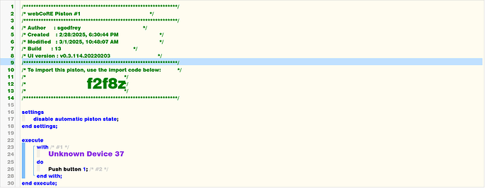

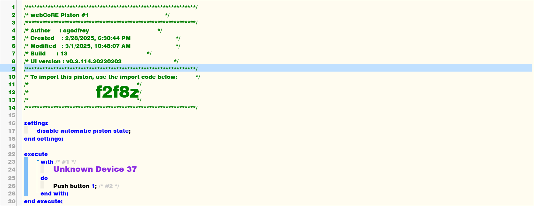

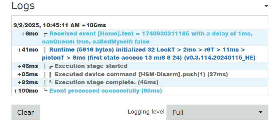

I don't see you disabling command optimization in the piston. Can you show the logs with command optimization disabled for the piston?
I have pushed an update to webcore to check for momentary attributes.
if you are using the user install, hpm 'repair' on webcore will let you get it
Let me know if this resolves your issue.
That works! Thanks.
