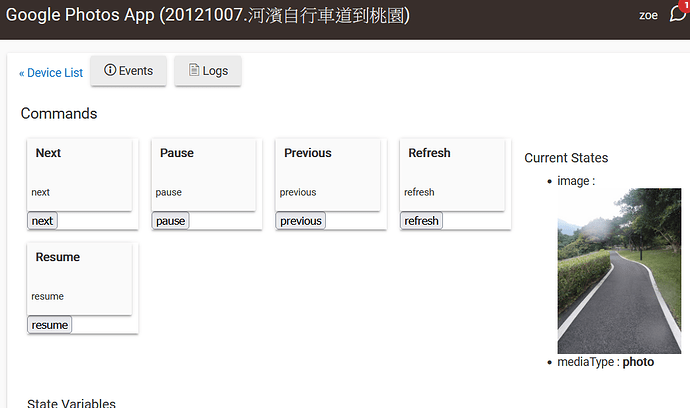

I've set up a Google Photo device and can see the photos on it.

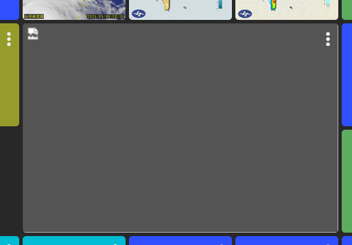

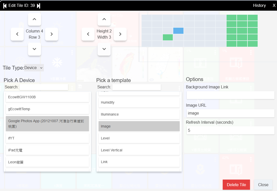

But when I add the device to the dashboard, the photos don’t show up. Any idea why this is happening?
Thanks!
result
Answer 5 posts above. Long Google URL.
