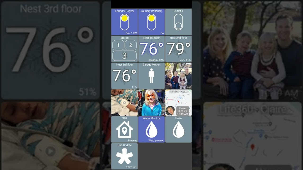

Images still work for me in HD+ dashboard.
This seems new to me (unless I missed it above) - what does it do?
