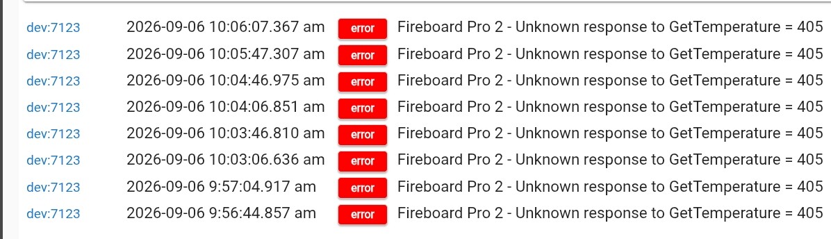

Just started getting errors in the logs from this:
The odd thing is that the temperatures are updating. It is just throwing the error which appears to not let me use the values in my rules.
Weird. 405 means that it is the wrong type of request to the server (like it was trying to do a GET when it should have been a PUT or such). Per the Fireboard API (just checked to see if they had changed it), only the Authorization Token request is a POST and everything else is a GET... which is exactly what the driver is doing.
So, maybe they are having some issues on their side at the moment? I guess we should wait and see if they resolve it or if it keeps happening.
Something must have been going on with their server. It came back, and had lost the names for my probes (renamed them back to the generic channel 1 and channel 2 - on the Fireboard Android app as well) This happened in the middle of a cook.
:man_shrugging:
Strange... But I have to admit I am happy it was not something on my side.
Yep, sorry for the false alarm. Apparently, I just happened to catch a cloud glitch real time. Yet another reason why local is better. Really weird that it lost my saved names for the probes (but did not for the temperature unit itself)
