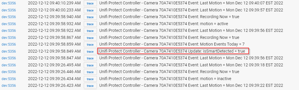

I have trace logging enabled in all the devices. Don't see any raw info in the logs, just this:
The only other thing that seems relevant is the "Bootstrap" data, which has entries for "person" and "vehicle":

You should not need to enable Trace logging for all the child devices, all that data flows through from the parent device anyways. Also, do you have the WebSocket Monitoring enabled? That would be more useful for the motion detection than the bootstrap.
However... I just reviewed my code and found I do not have good Trace logging for the WebSocket portion. That might be why you did not find anything useful from it. I will add some in and get a new version posted shortly.

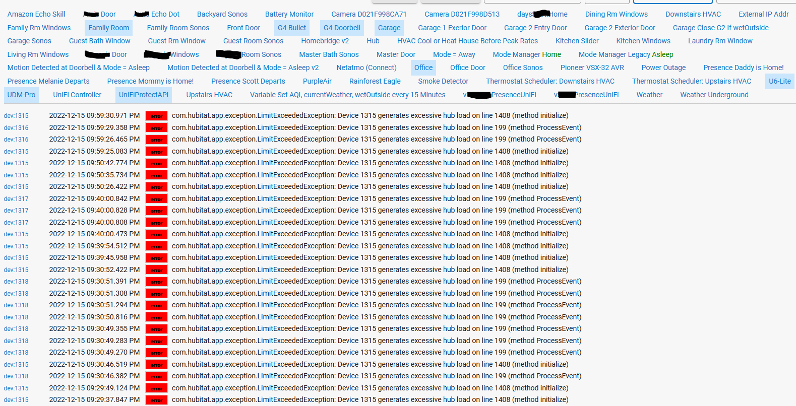

Device 1315 is UniFiProtectAPI. I'm running the latest versions of all drivers.

So couple things here:
- WebSocket use is going to cause a lot more events and can potentially generate warnings from Hubitat. These are NOT error logging from the drivers but rather Hubitat stating that the device is being "too chatty" you could say. You can up those limits in the device settings (the ones for the device itself, not the Preferences). The WebSocket is purely driven by what the controller is sending out. With multiple different cameras (from what you show) I would expect a lot of traffic. That said, I AM working to try to cut down on the Events in the version I am working on now by getting rid of the WebSocket status portions, and just leaving the actual motion or other events.
- That COULD be perfectly reasonable because you can tell Protect not to include certain APs as Bridge devices on the Unifi controller. In which case it likely would not include it in the data. However, that is not the default so I would expect both to be in here. Can you send me a message with Trace logging when you perform a manual "GetProtectInfo"? I want to make sure what it is sending for Bridges. To be honest, I am still debating if there is any VALUE in providing the Bridge listings in my Protect driver. There is not really anything anyone can do with them. I added them more for "completeness" of what the API provides.

I do not know what is causing this. The method itself is very simple and reused on MANY of my drivers and has never caused an error before. I wonder if Hubitat has changed something that is now causing these to crop up (right or wrong).
@bobbyD: Any idea why these errors might be cropping up when they have not in the past? The ProcessEvent method has not changed for quite some time.
My guess is the frequency these calls are occurring (many times a second).
I'll try to have a look at it later today.
I found the trouble maker, or at least a cause for many refreshes to be performed. It got stuck into the WebSocket area... So the WebSockets were calling for Login and refreshes if they were initialized, which apparently just happens a lot as is.
