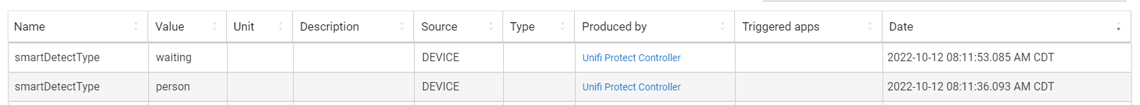

I have adjusted the settings on one of my devices to only capture smart detect events. I don't believe these show up as normal motion events though. In tomw's driver, the two different events are captured as different event types (motion vs smart detect). I will let you know my findings later.
Here's how the smart detect show up in Unifi Protect vs the drivers. Let me know if you need more info.

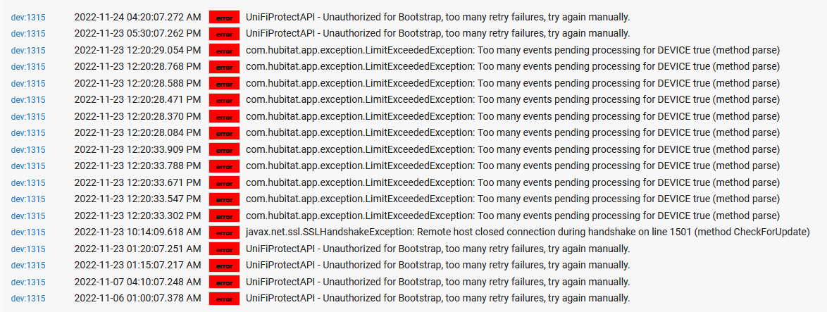

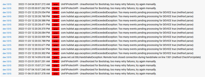

Ugh, that is not good. This looks very much like what you had happening before (back in September, why did it have to be OK for almost 2 months then come back), and at that point it seemed to be the cookie timeout. I assume that you did get it upgraded to 0.2.11?
Not sure about that handshake error, I have NEVER seen that one before although that is going to my website for the driver version check. Maybe my server was being flaky?
Did you try doing a manual refresh?

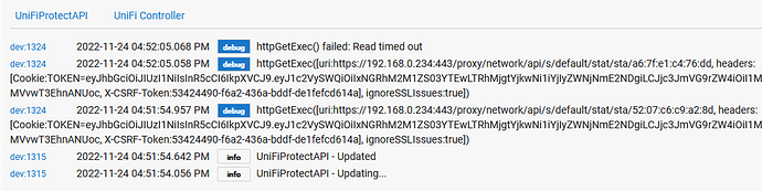

Using -0.2.11 driver:

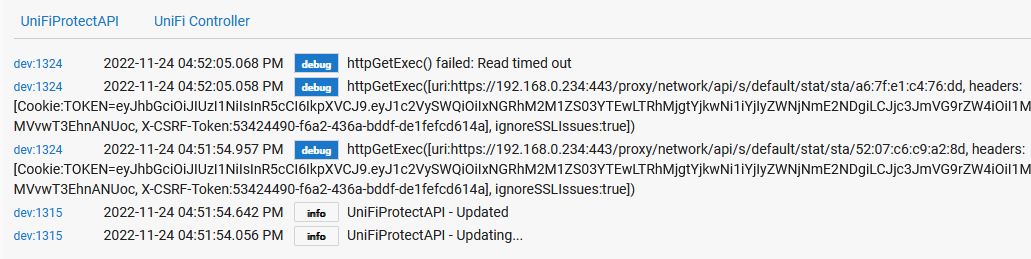

Turned on debug logging and clicked Refresh:
UDM-Pro UniFi OS v1.12.22
Network v7.1.66
Protect 1.21.6
Did you click refresh in the parent device or the Controller child device?
I clicked Refresh on the UniFiProtectAPI device.
Sorry, the "UniFi Controller" Device isn't your code. I should have stripped that from the logs.
Device 1315 is the UniFiProtectAPI device.

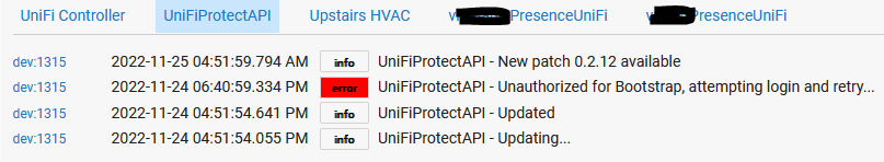

So since I clicked Refresh yesterday I haven't see the same errors:
Looks like my UDM-Pro was borked? I rebooted it. Will let you know if these errors reappear.
Thanks. Are you running one of Ubiquiti's Early Access versions or just the normal stuff. Wonder if there was something weird there.
