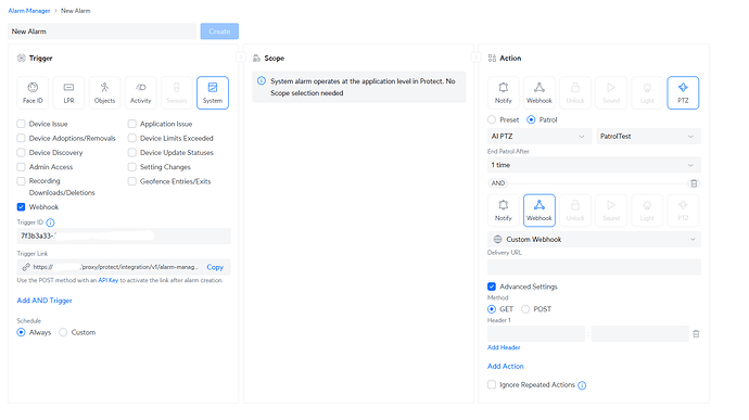

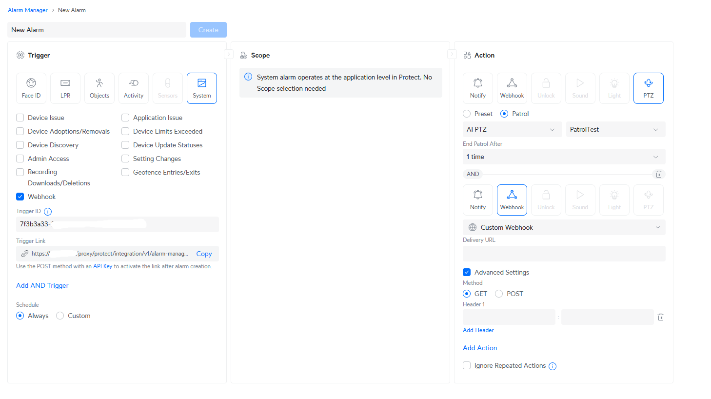

If a person doesn't have a newer PTZ camera set up they wont be able to see all of the options when creating a system alarm webhook. This is what it looks like:
You create the alarm and you get a trigger ID for it. You need to have an API key that you send in the header for auth. That's where RM out of the box is a barrier since you cannot add a header there. No auth header no webhook call. Perhaps there is a way hidden in the API to trigger an alarm with the triggerID vs actually making a webhook call. I do not know.
Alarms have lots of options so putting logic in the alarm VS hubitat can make a lot of sense. In the image there I am configuring the alarm to trigger a configured Patrol on a PTZ camera. You can set how many times you want the patrol to run. The patrol has its own configurations on delay between favorites etc. You can configure a patrol to make it sweep the full view etc etc. You can then also stack the actions on the alarm so you can call other webhooks or notify etc. If you have other Unifi products they also have actions. At the moment I do not have Access, the horn or sensors so those are not enabled for me. I'm waiting on availability and delivery.
Yes, I understand you can control the camera. Alarms are out of band and run independently and also show in the logs. For some that has value. I don't see it as a replacement for what you are doing already. More or less just rounding out the feature set.

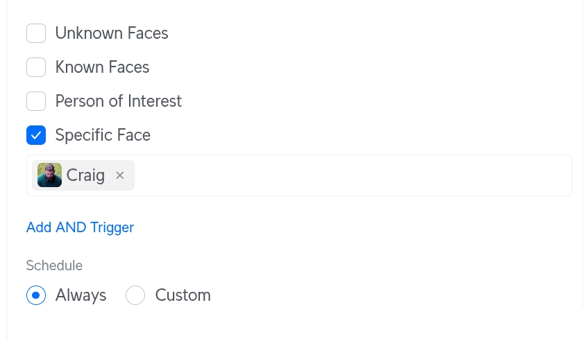

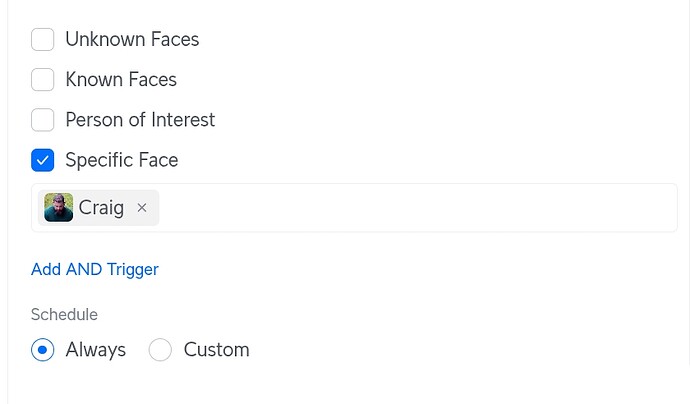

You are using "Known Faces" instead of "Specific Faces" in Unifi Alarm manager. These means you can't link a specific person to the alarm. Update the Alarm in Unifi Alarm Manager to use specific face and then update the webhook to specify "Face" for the "type", and then include the value item with the persons name associated with the alarm.
The unfortunate thing is that Unifi Alarm manager doesn't have a way to send variables through through the webhook call. This means you need to have it be very specific when you setup the alert and setup a different alarm for each person.

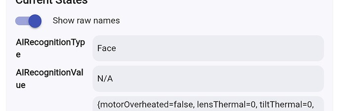

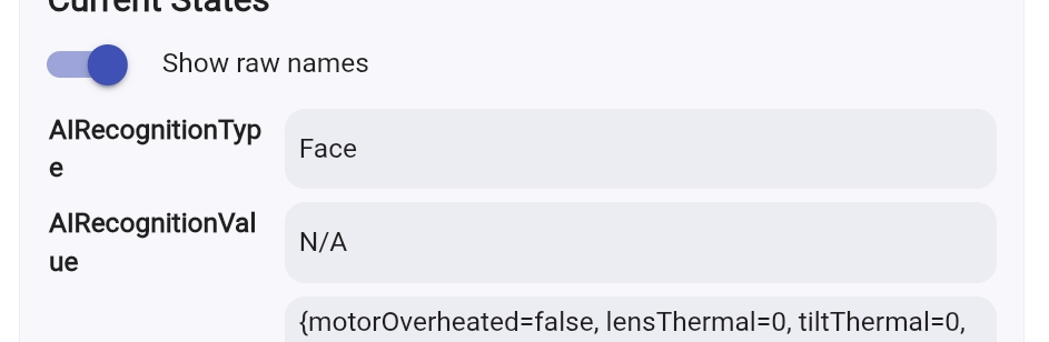

These should update the AIRecognitionType and AIRecognitionValue shown in the image below. I will take a closer look at it since as you see mine didn't update either.
I just noticed a bug in my code which was prevening the Value from being passed. I just updated the code and posted it to be downloaded. You should be able to download the updated code now if you are using HPM
