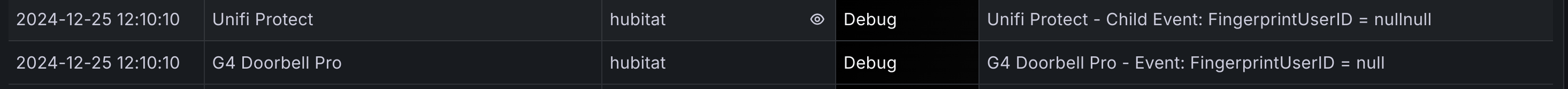

I know I had asked before about the fingerprint sensor. Just trying it out again and what i noticed in the logs are a few entries that seem to related to a GUID. Here is a example of what I observed.
 metadata:[fingerprint:[ulpId:aa8231a0-xxxx-xxxx-xxxx-d4257b0183a2]]
I also saw:
FingerprintUserID = nullnull
Which that of course is useless.
So if we are suppose to use the guid included in the first items where is that found on the device details to run rules against?

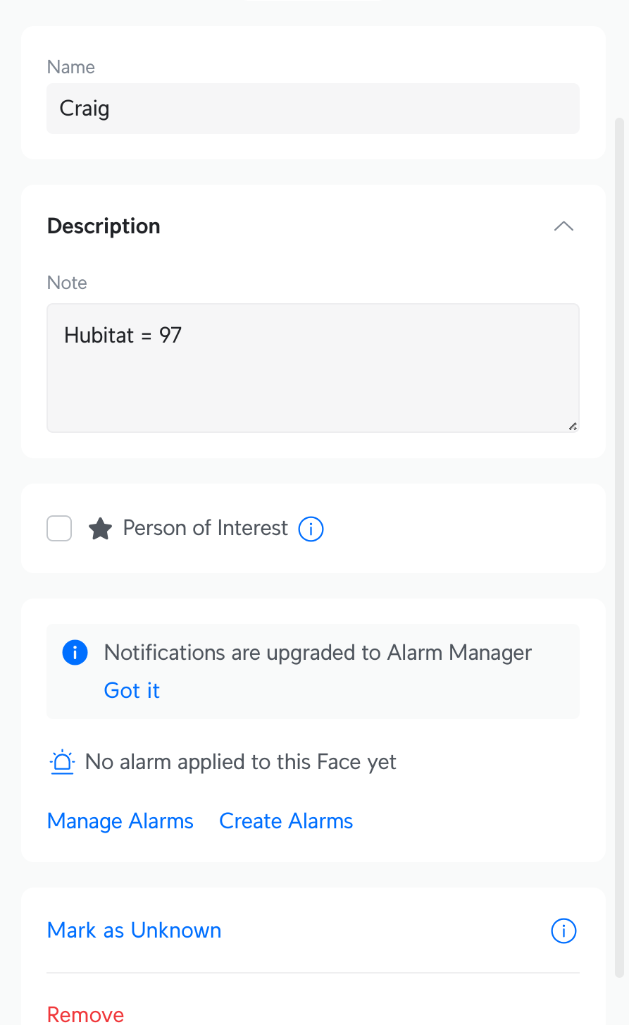

From what I can tell right now the big thing the AI Port will enable is Facial and License plate recognition. I only walked in front of it a couple of times and i am getting recognized by the camera now. The facial recognition events it generates currently in HE are simply "SmartDetectType" events with a number.
Only reference i see of them is this in the log:
Unifi Protect - Child Event: smartDetectType = 97, null

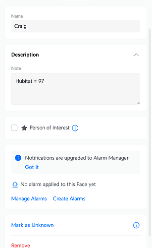

I suspect this isn't the case. When I step the fingerprint I had to select a associated profile so it certainly matches back to me and my UI account. I think that is because of the potential Unifi Access tie-ins. When I setup the facial recognition it is a much more basic setup. It is literally 2 fields a star to enable to make the person, a person of interest. Here is the below setup screen shown when setting it up. You can also setup alarms for that person from that screen as shown below
I can see how this make sense in a commercial environment, and why it wouldn't make sense to attach it to a Unifi account local or otherwise, but that doesn't help you or the use case for home users.

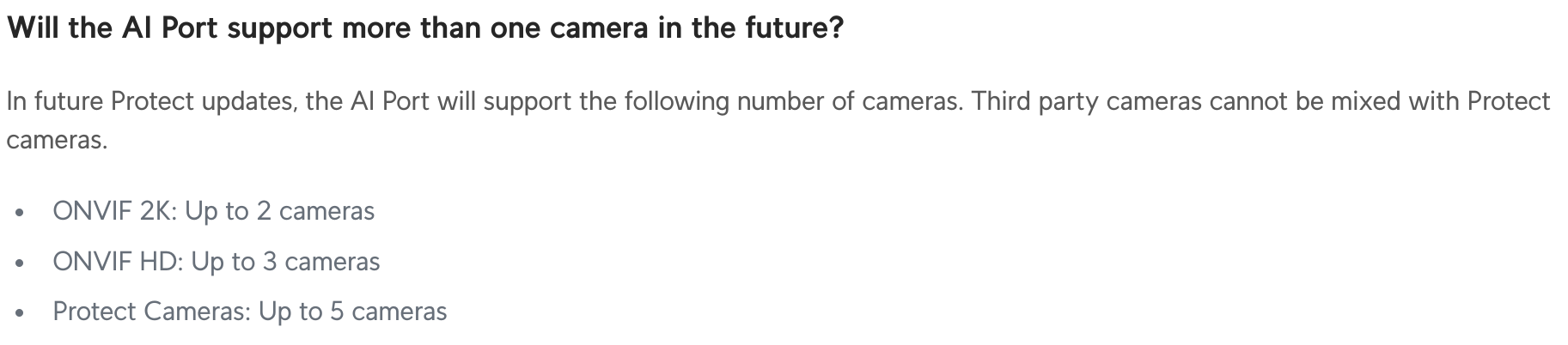

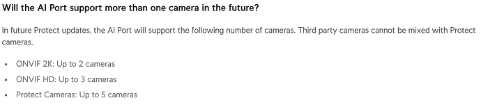

The AI port so far has been pretty nice though I do have one fairly big dissapointment. When I decided to get it one of the encouraging things I kept hearing was the ability for one port to support multiple devices. That currently isn't true. It only supports 1:1 right now.
I found this on UI's site this morning with a bit more research.
The ID should be stored in the "FingerprintUserID" attribute/Current State on the Doorbell child device. It gets set if there is a webSocket event of type "fingerprintIdentified" at this time.
Maybe the facial recognition is meant more for tracking someone around an environment between cameras? Ubiquiti is certainly making a stronger push into commercial (and blatant educational) networking environments.

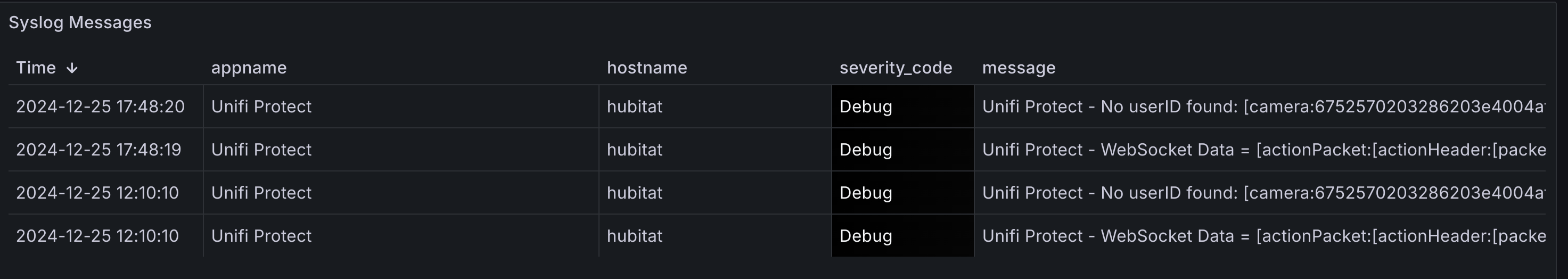

I need to check my setup as this doesn't appear to work for me right now. I don't see the attribute at all or an event for it. The logs from yesterday's test already rolled off the HE so I had to turn to my syslog server. When I searched for the "fingerprintIdentified", I did find two sets of events as shown in the below image from Grafana. All of them are from the Unifi Protect parent devices and nothing from the doorbell.

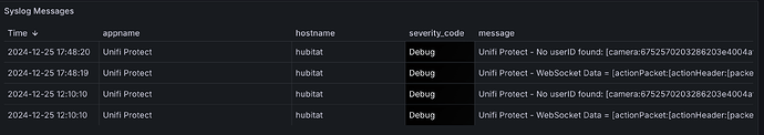

Here are the details from one set of the events.
Unifi Protect - WebSocket Data = [actionPacket:[actionHeader:[packetType:[1], payloadFormat:[1], deflated:[0], payloadSize:181], actionPayload:[action:add, id:676c3c7203904503e40015ce, modelKey:event, newUpdateId:e3f16413-9f87-4765-9af1-639bacda61a8, recordId:6752570203286203e4004af0, recordModel:camera]], dataPacket:[dataHeader:[packetType:[2], payloadFormat:[1], deflated:[0], payloadSize:354], dataPayload:[camera:6752570203286203e4004af0, end:1735146610909, id:676c3c7203904503e40015ce, isFavorite:null, locked:false, metadata:[fingerprint:[ulpId:aa8231a0-xxxx-xxxx-xxxx-d4257b0183a2]], modelKey:event, partition:null, score:0, smartDetectEvents:[], smartDetectTypes:[], start:1735146610909, type:fingerprintIdentified, user:null]]]
Followed by:
Unifi Protect - No userID found: [camera:6752570203286203e4004af0, end:1735146610909, id:676c3c7203904503e40015ce, isFavorite:null, locked:false, metadata:[fingerprint:[ulpId:aa8231a0-xxxx-xxxx-xxxx-d4257b0183a2]], modelKey:event, partition:null, score:0, smartDetectEvents:[], smartDetectTypes:[], start:1735146610909, type:fingerprintIdentified, user:null]
I then dug into the log server to see if there was any reference to it in the G4 Doorbell device that didn't reference that event as it appeared to be directly related to the webhook.

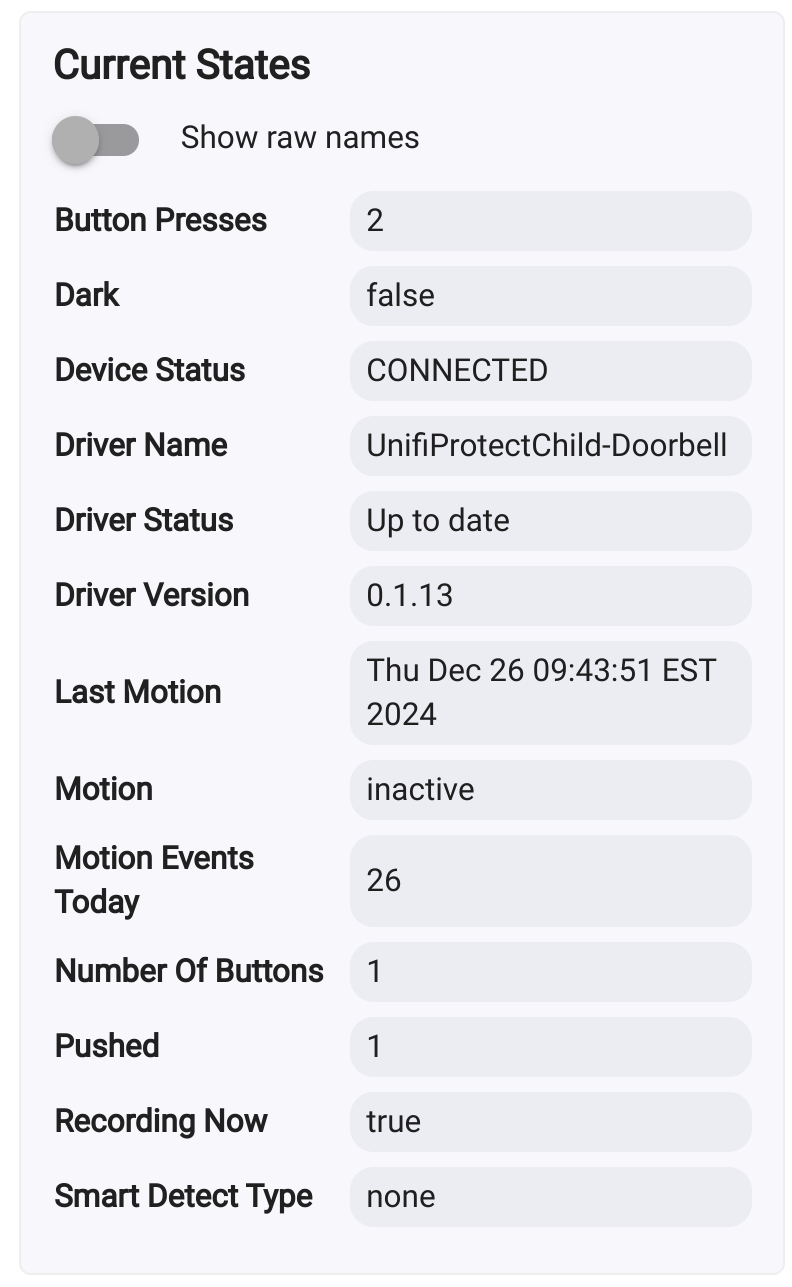

Does HE not post null events? Below you can see the devices and the "FingerprintUserID" is not present.
Restarted Unifi Protect to see if that helps kick something to behave better. I have seen mentions of that helping with certain stuff on their forums. I will let you know after my next set of tests.

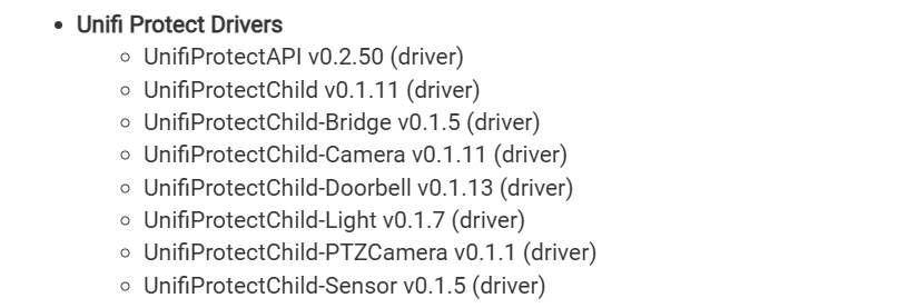

Updated Version(s):
  • UnifiProtectAPI.groovy = 0.2.49 0.2.50
Change(s):
  • Change to how SmartDetectType string value is created in some scenarios... not sure what I had going on with the old method of it.
  • Added a bit of additional data handling (posting to State Variable) for new data coming from the API.
  • Added a new websocket type that I saw returned, still need to work out the details of it and what it actually provides before I decide if it needs to become an Event, since it only has appeared with my NVR and has had no actual data associated yet...
  • Corrected typo the previous version introduced.
