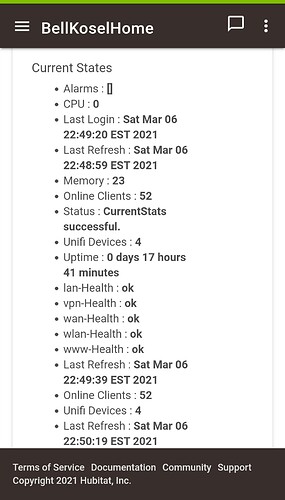

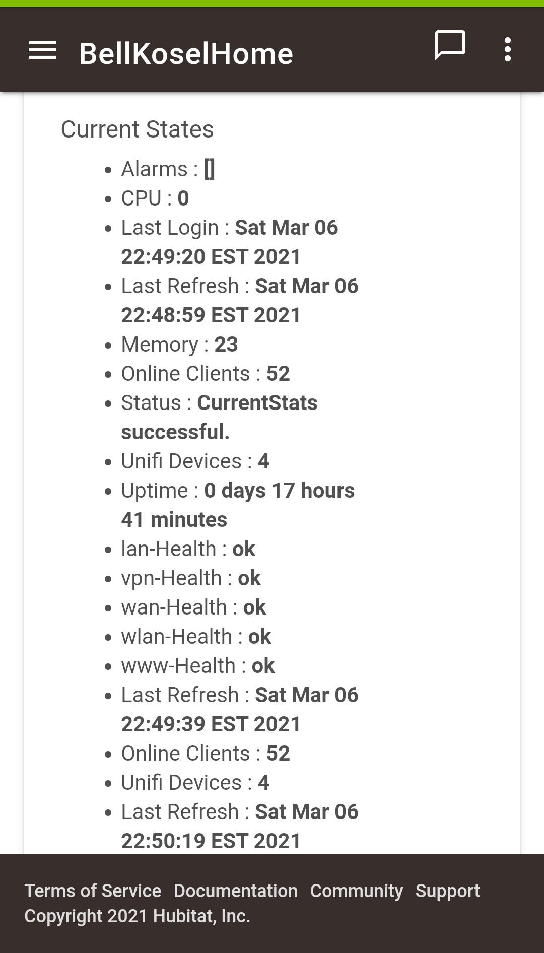

Just checking in about a couple things.
I have a USG with CloudKey2+ on 6.1.65 controller.
Only way this worked for me was setting to UDM.
Cpu says 0?
What exactly is "Alarms" for?
I also have 5 devices yet it says 4?
@markbellkosel84 let me go through the questions:
  1. If you can send me a Trace log across when you run a CurrentStats command I can check why the CPU might be zero. In the typical data (if it is reported) it usually comes across as the % with one decimal place (ex: mine is currently 12.0), Memory is the same (mine is 40.1 at the moment). Since your Current States values for those are lacking the decimal I wonder if it is being reported differently.
  2. Alarms is a list of any "alarms" the controller might currently have. An example would be if it detects a Rogue AP it will raise an alarm. That would show in here until you archive them at the controller.
  3. The number of Unifi devices is based on what I get in the CurrentStats command, so the Trace from #1 could help here also. Right now it adds them up based on what the controller has returned for the wan, lan, and wlan segments (I have no examples showing it with devices in vpn or www). If you do not mind telling... what Unifi devices do you have? Combined with the Trace I can try to see where I missed adding one in.
