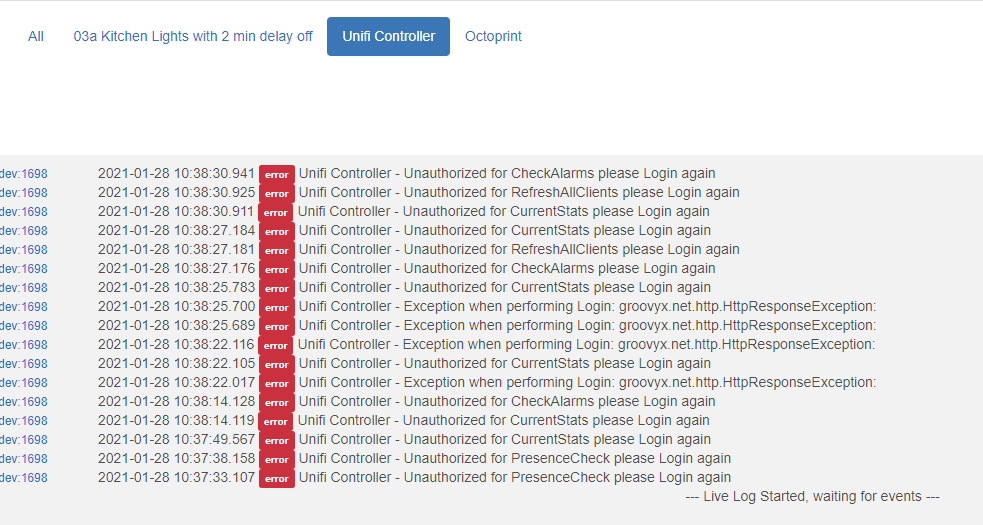

Not sure if this is the correct location, but since the lastest update to HE 2.2.5.120 I am having issues with the UNIFI controller login. I did get this every few days but would just go and click login and it would work again. Now this does not seem to work?
I am not having this with mine (on 2.2.4 or 2.2.5) so let me ask a couple questions:
Nothing has changed about your Unifi password? You can login normally to the controller itself?
Have you upgraded to the latest version of the UnifiAPI driver (0.2.3)? Did this happen before the upgrade or after?
I will have to change the logging a bit regardless to try to give more detail when there is an exception like that... but the overall problem should not be happening of course.
Yes I can login to the unifi controller fine. Yes mine is updated and was working okay, every few days I would have to go in and click login and it would work fine again.
Now it wont login at all. I am on the latest Unifi controller version 6.0.45 running on a raspberry pi 4b 4GB
