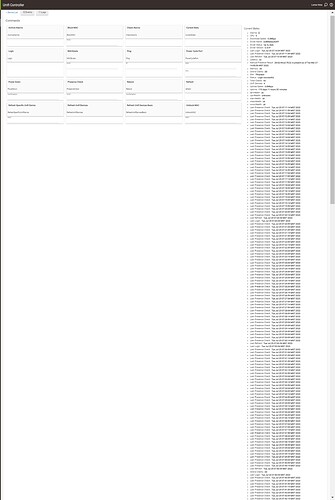

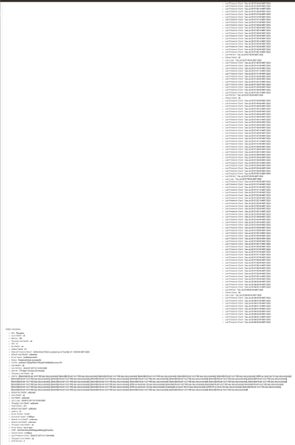

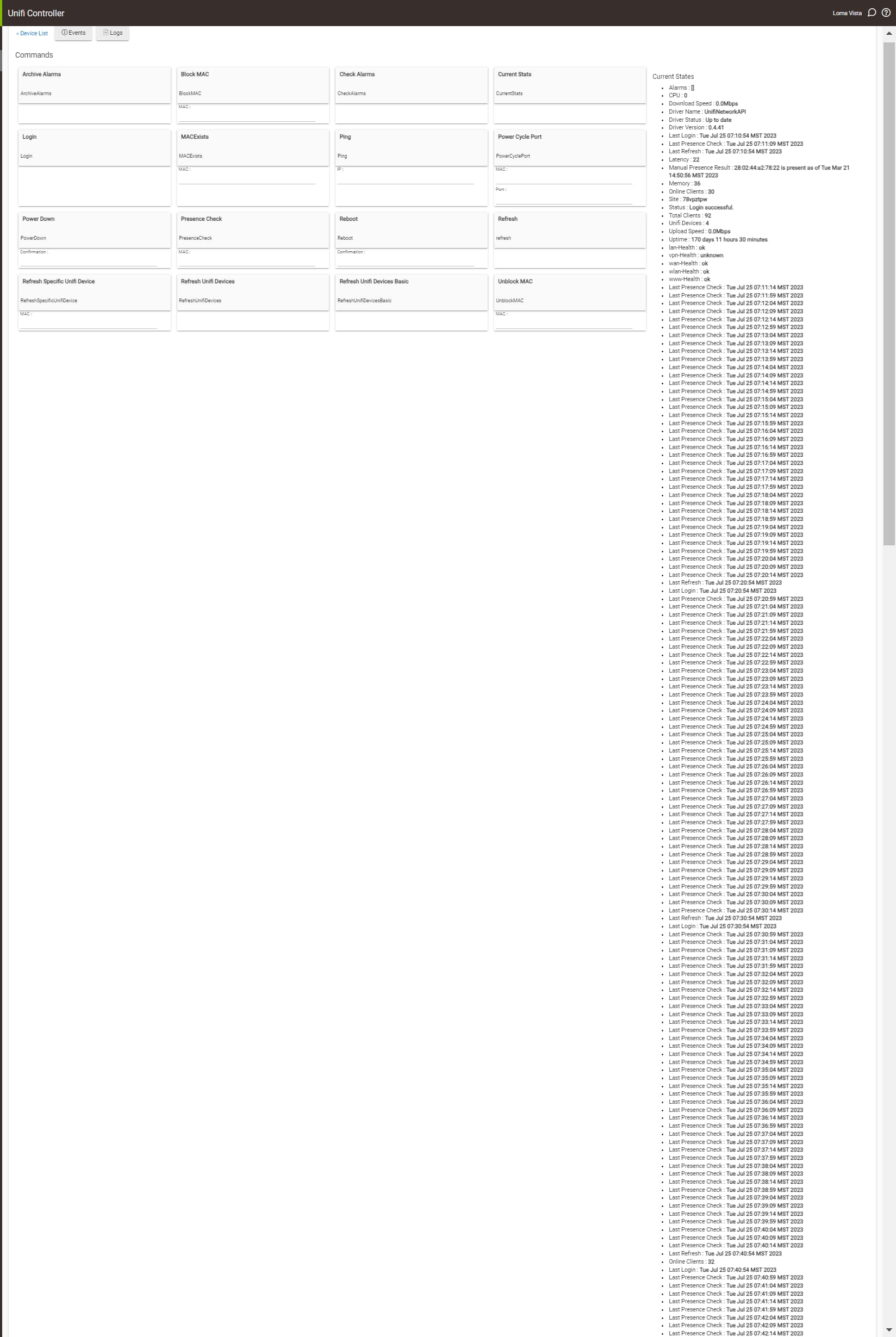

Question: my Current States list for the Unifi API device gets flooded with Presence Check messages that seem to accumulate forever and makes a REALLY long list. Is there any way to change this so that it only shows the most recent, or perhaps the 3 most recent presence checks? Or a clear button?
If you refresh the page all of those extra Presence Check messages will go away. This is a visual issue that I have raised with Hubitat but it is not going to be fixed (it is not directly them either, this is just an oddity of how all the background code IS supposedly). Basically it has to do with Events (attributes) that have spaces in their name (or some other characters). They WORK perfectly fine, and the most recent WILL be the value used for Rules or what have you. But they can build up visually on the webpage of a particular device if that page is left open (like Logs build up if left open).
MANY of my drivers have this issue because I went with easy to read names for many attributes (and did it for YEARS) before this was finally figured out. I am trying to reduce the number on future drivers, but rewriting all the attributes for existing ones (and causing all users to rework their Rules or such) would be a painful process.
Ok cool. Thanks for the explanation. ![]()
