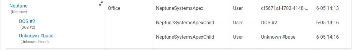

- Added a new child driver to support Virtual switches. Turns out (I had forgotten about this when I reset my Apex earlier in the year) that Virtual switches get identified as their own module in the system. When I tried to add support in for them on the controller child it caused a mess. So I gave them their own child. The events can only display up to an 8th virtual switch, but it can control (since you set which one you want to change manually) and display states for as many as you might have.

- Support for detecting a Sicce pump that is connected to the Apex. It may actually identify other pumps (and create child devices as if they are Sicce pumps) as there appear to be three varieties listed in the "type" that the Apex returns.
- Should create "Unknown" children using the generic driver if an unidentified module is detected. Please send me a status.json (and tell me what the module really is) if that happens so I can identify the module going forward and add support for it.

@snell anyway to track the amount of dosed of liquid from a DOS? So I can alert after x amount?
I do not know. I do not remember seeing any samples of the status.json that included a DOS and I do not have one (which is why it is on the questionable side for identifying).
Since I do not have one (I keep looking for a cheap used one) I do not know how it functions and how, or what, it reports back (even outside of the status).
I reached out to BRS about the REST API that Apex controllers have (since Neptune Systems never had replied) and they forwarded it to Neptune Systems... Where it is not getting a reply like normal again. Frustrating.
What can I help get you with the DOS? I haven’t upgraded to your latest code yet because I’m about to go out of town for a few weeks but will likely be upgrading my hub to separate out my ZWave and zigbee and cloud hubs so will upgrade at that time. Not looking forward to the mess this change is going to make. Lol
If you (or anyone else that has a DOS) can shoot me a snippet of the DOS section from the status.json and a screenshot of the DOS summary from the Apex pages.
I have one sample... But the values the DOS section showed did not seem to correlate to what the DOS showed elsewhere. So more samples might help figure that out.
For those that use Chrome and are willing to dig a bit deeper into their Apex, shoot me a PM and I can provide some instructions to try to get some more information out of it.

- Added DOS detection back in. It used to work but had been removed when I went to the new module detection method. Samples provided have made it so I can add it back in although I am still working on trying to get more relevant data for those DOS (not necessarily what it provides in the status.json).
