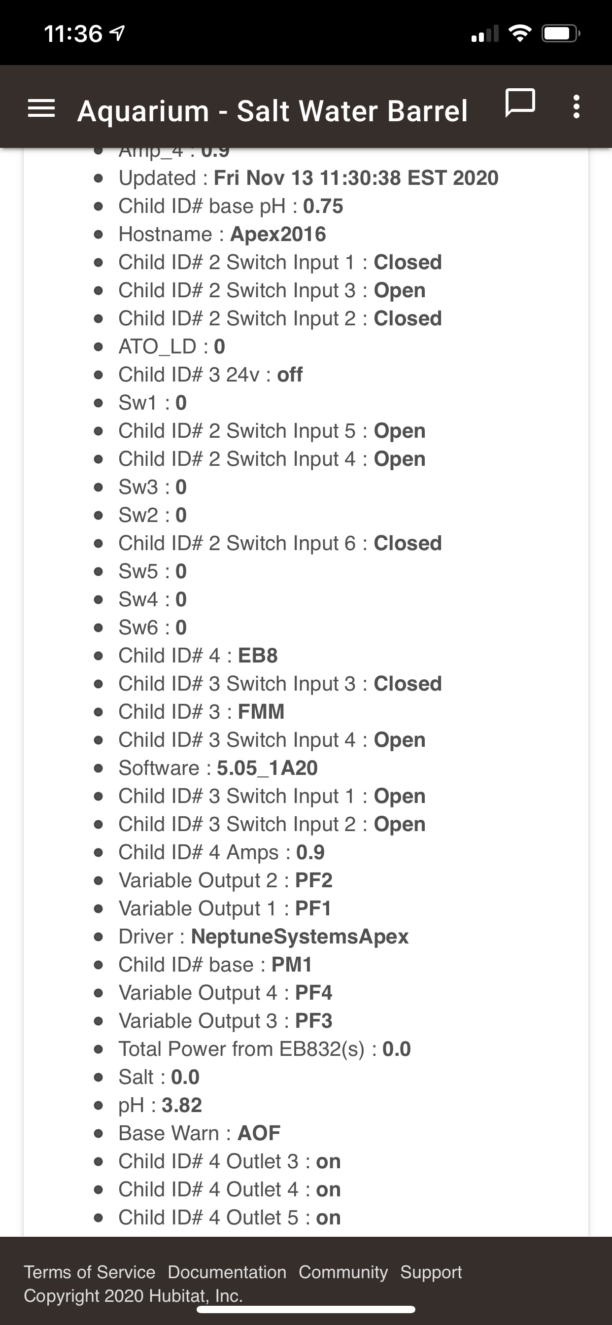

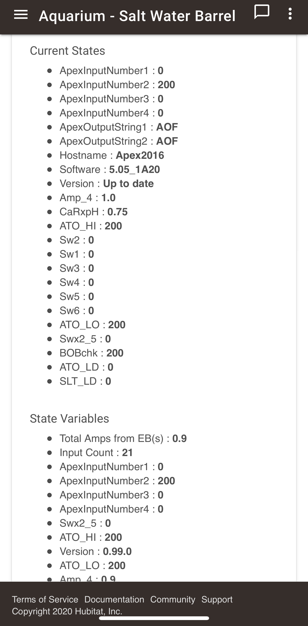

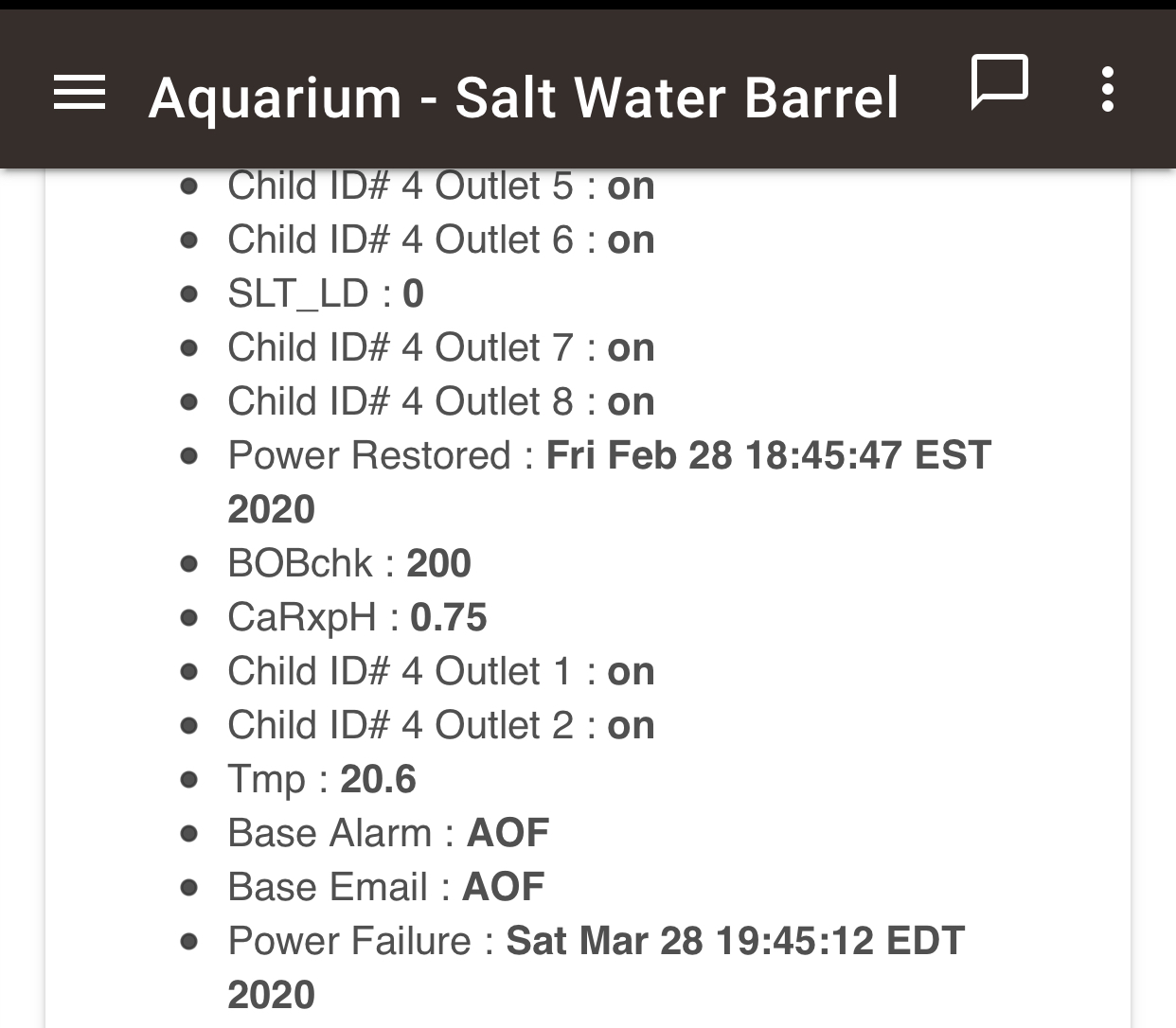

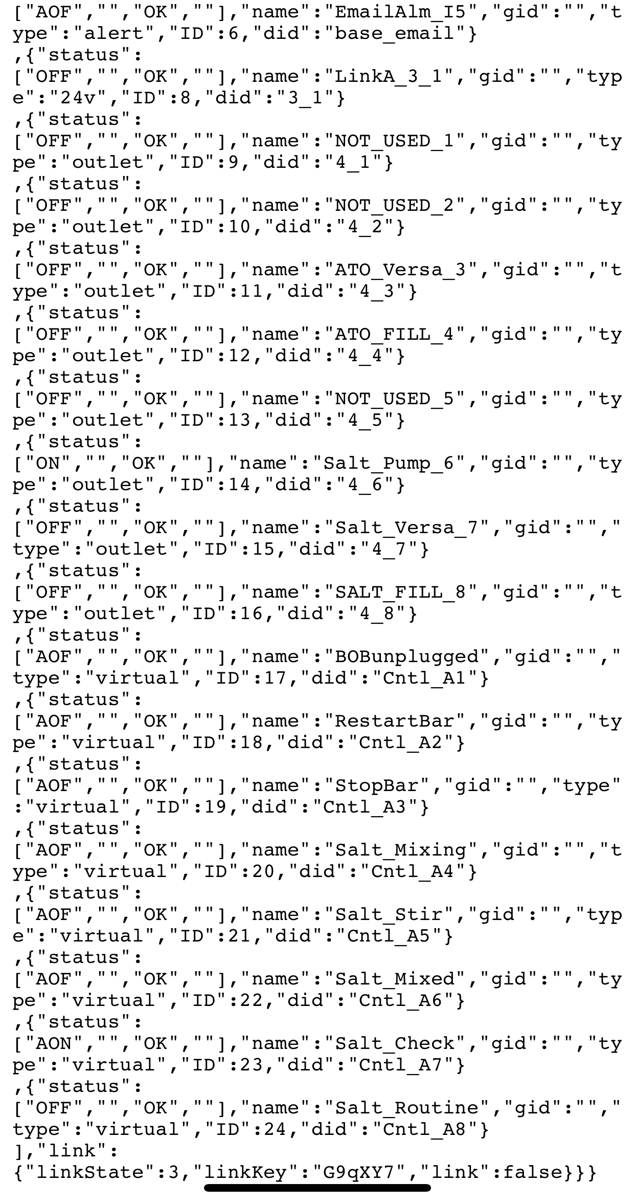

@snell I’m having an issue where my physical outlets on my eb8 (haven’t hooked up an eb832 yet) are not showing up in the device listing... virtual outlets show just fine. I’m not using the child driver but your latest release and child driver are installed. I know they were seen before and worked but something happened and now I can’t see them. Do I need to use the child driver?

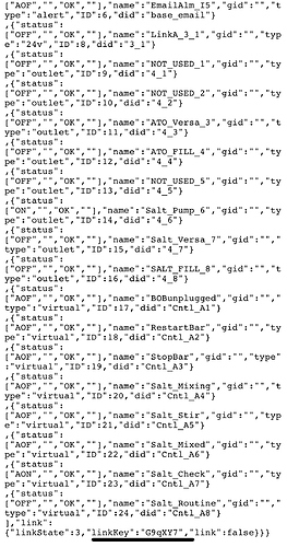

I think I see what’s up... my eb8 is child ID4 which shows all 8 outlets (not named however like they used to be), but in the Json most are in an OFF state with only certain ones ON. In hubitat, it’s showing them all listed as “ON”. Why is it not registering correctly?
I would recommend using the child devices... but I can try to take a look and see if I can figure something out with it. It has been a bit since I have tried things with just the main (no children) so maybe I broke something?
I can see from the screenshots you are using the latest driver, so at least that is all good.
There is definitely something "fishy" going on with the state variables in the parent. Checking mine and they should not all be on. (DOH). Annoyingly, the CHILD device for those same ones seems to be working fine from both the Events AND the state variables...
Now you've got me curious what I broke. I was JUST about to call it an evening on drivers, but now I am checking this real quick.

A couple of the state variables were being set to "on" when they should have been displaying "off". This did not affect the child devices, only the parent device's state variables representing the outlets and for a dos.

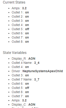

It will be a single parent with the child devices (it should create one per module you have connected to your Apex) below it. Each child should have State Variables but then they should also have Events (Current States) for their specific features. The children get their values from the parent when it does the refresh. The only command I gave children was one to clear out their State Variables.
Here are a couple screenshots of mine. First is the overall device view showing the parent and children, second is a compressed view of from Child Device #3 (an EB8).
