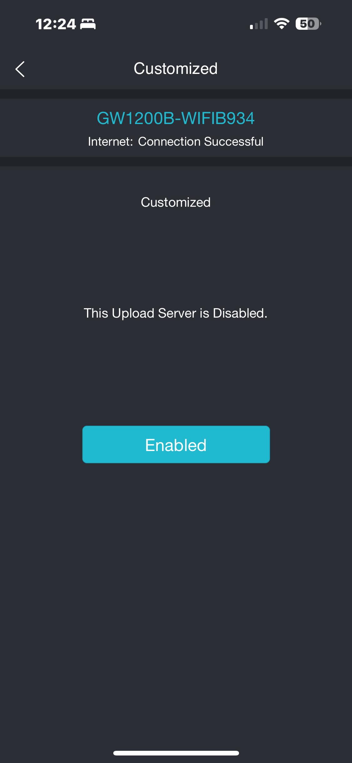

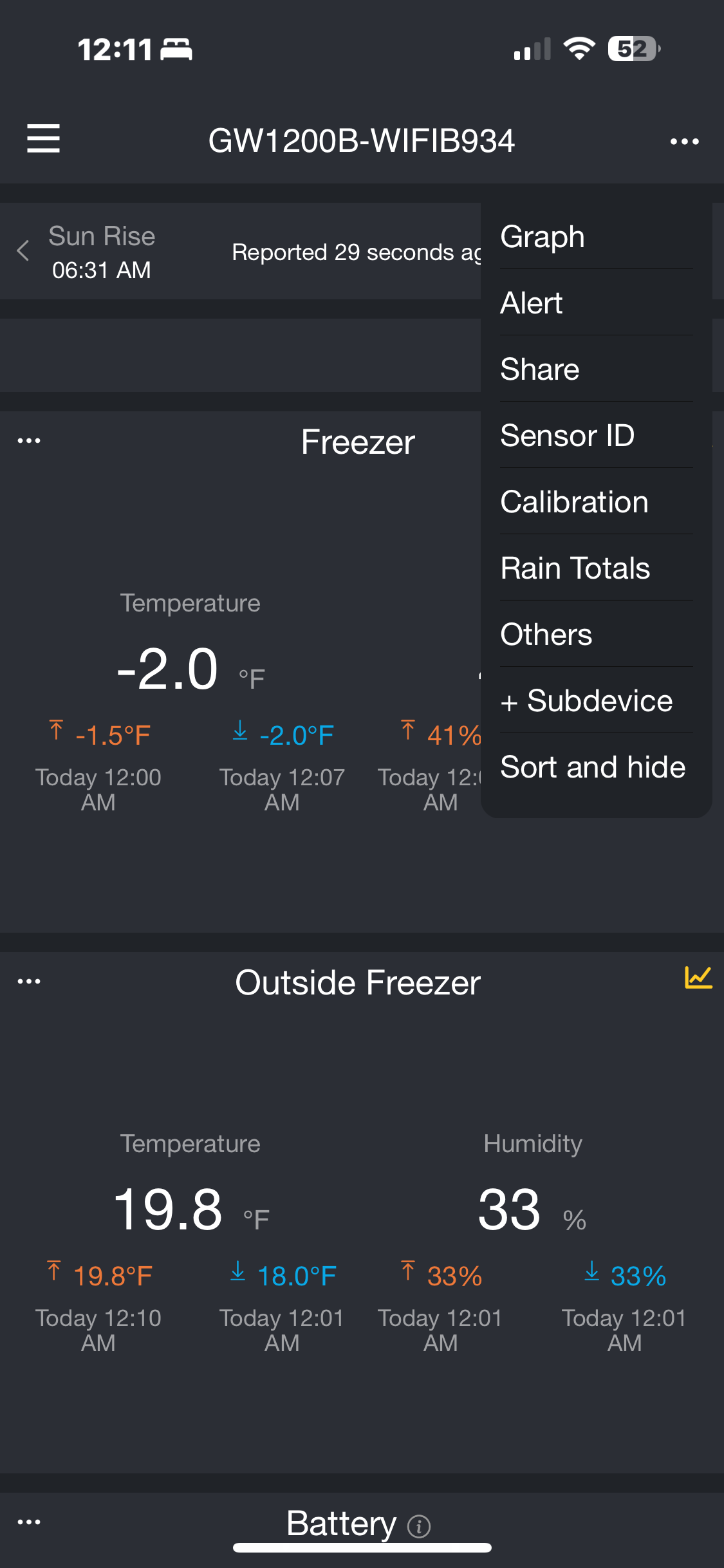

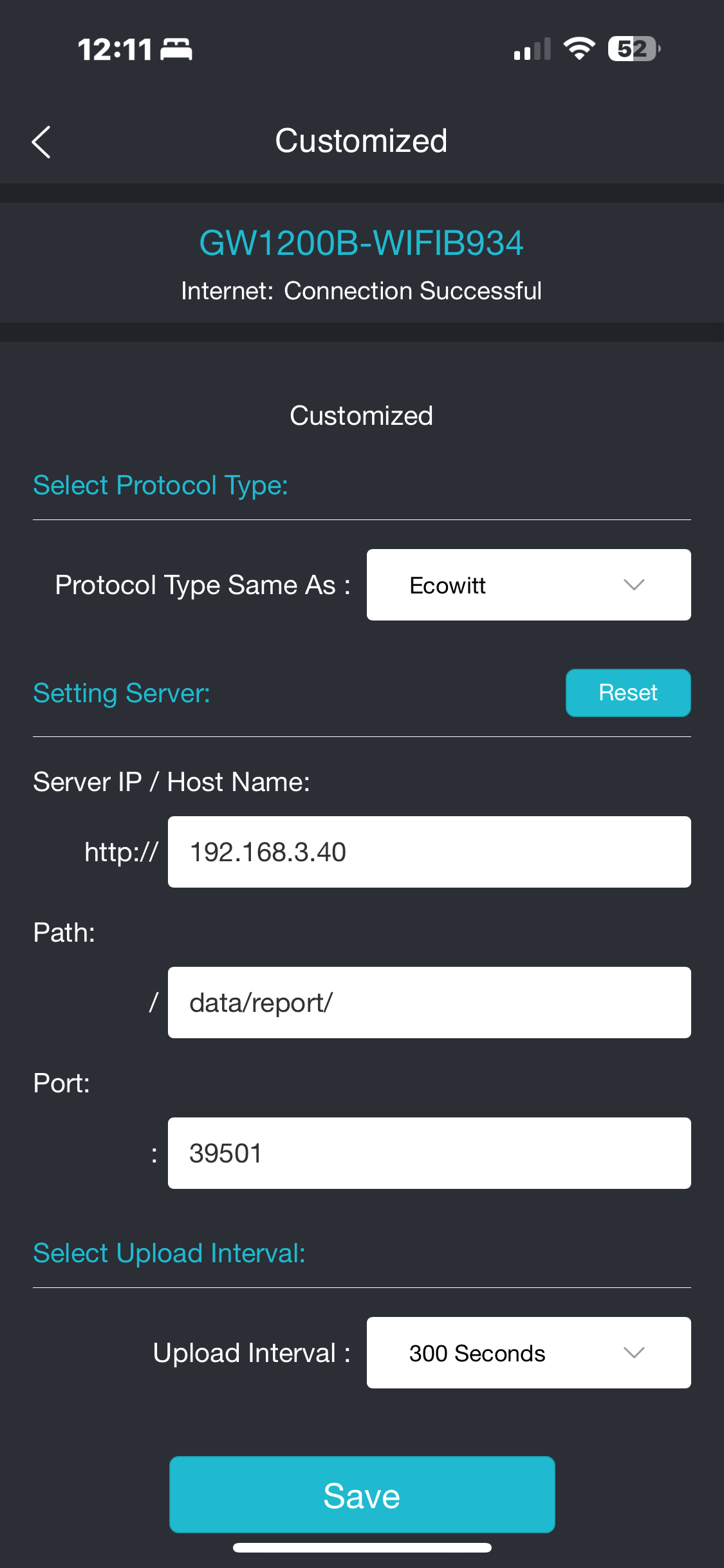

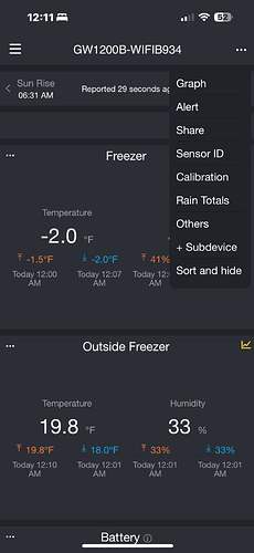

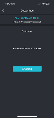

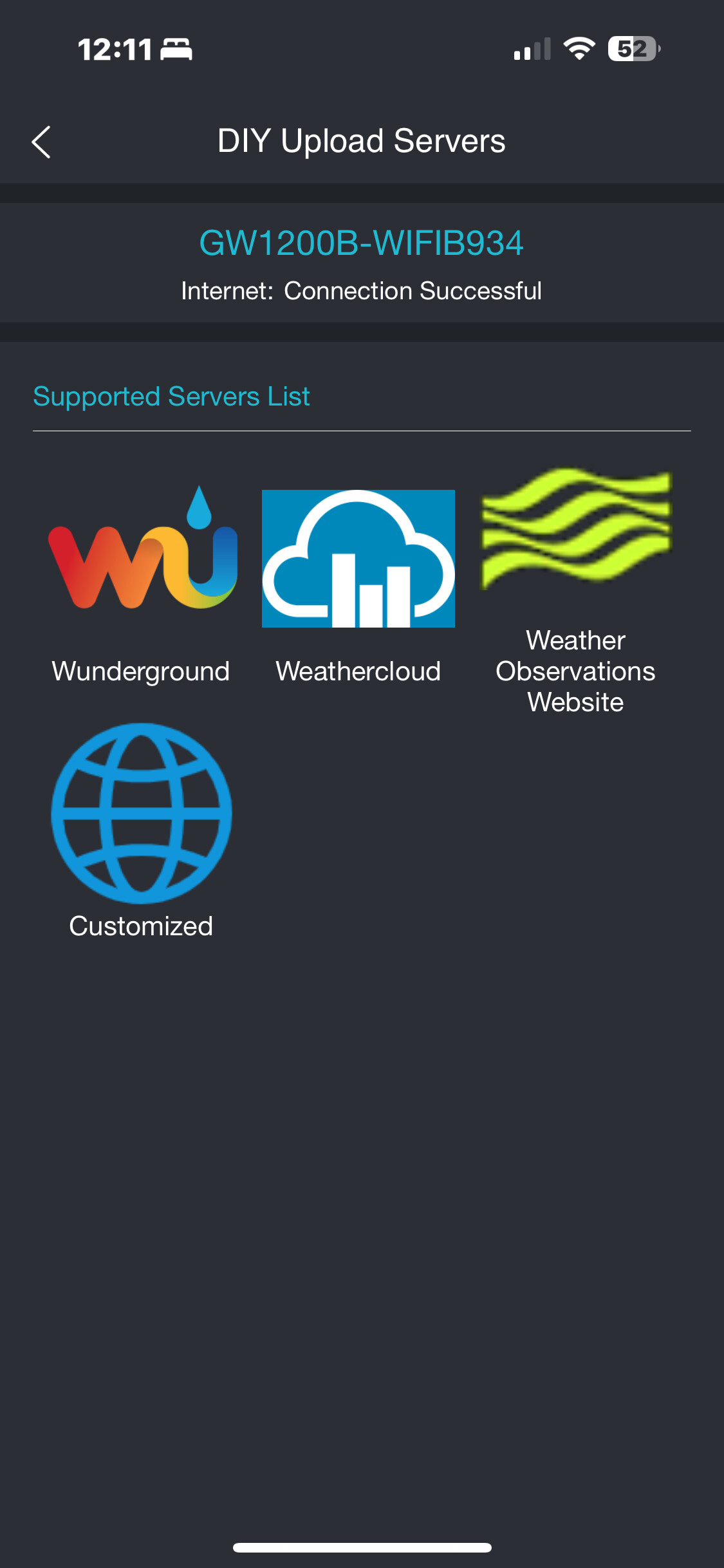

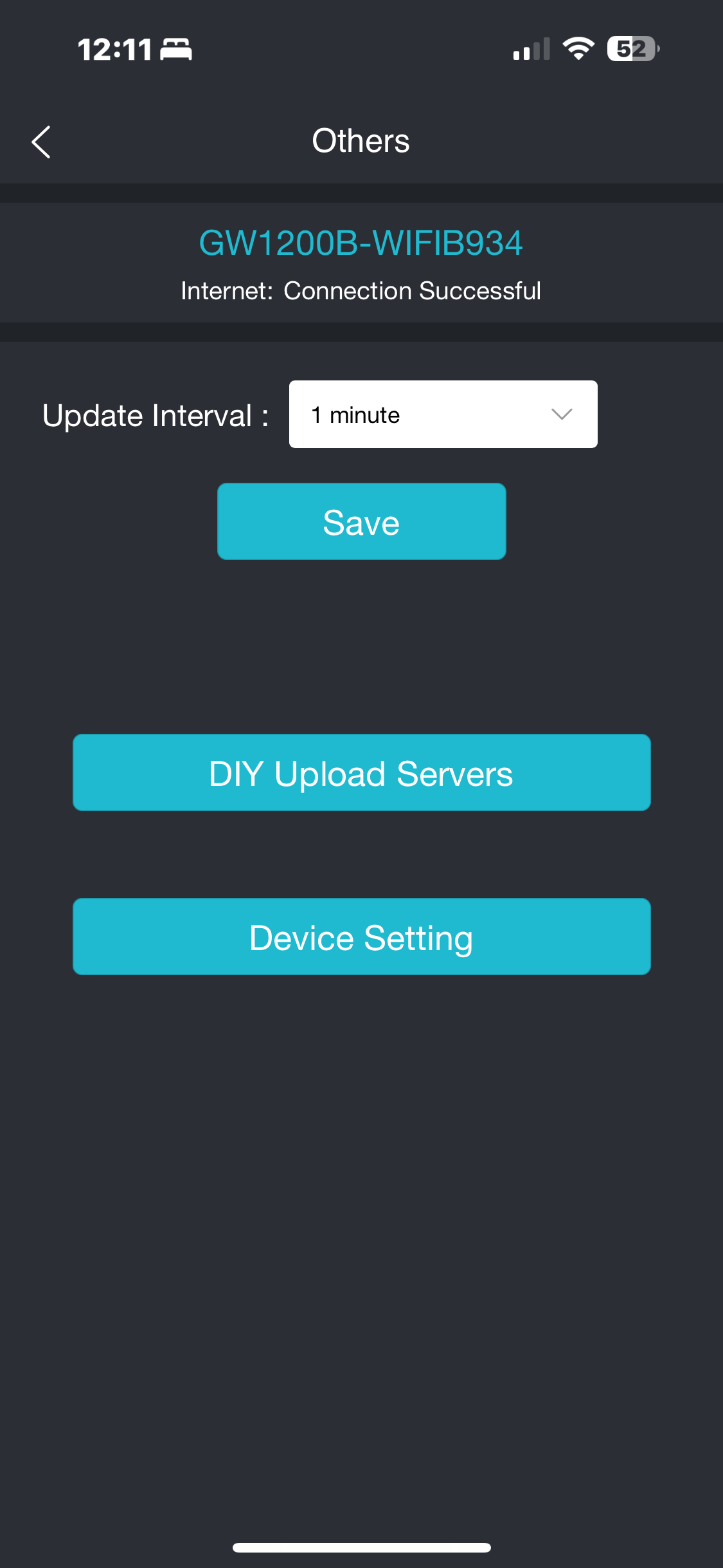

@snell here are the screenshots you had requested from the other user.
In the 4th screenshot, "Enabled" button should actually should be labeled "Enable".
Thank you for this fantastic set of drivers!
Ecowitt just responded to my email saying that they will "correct this spelling error shortly." along with Disabled -> Disable on the Customized screen.
Actually, it was @sburke781 that asked that it be moved over to one of the other Ecowitt driver pages here.
From my perspective, those look like fairly typical screenshots if you want to direct the data to a Hubitat for my driver, which is this thread, or another driver (such as the one linked above).
@snell, sorry. Got my threads mixed up.
Which does remind me. Could you please update the instructions for Ecowitt Local setup in your main driver? I spent an embarrassingly amount of time trying to find that Customize screen in the Ecowitt app. Hopefully will save another person some time.
Which app were you using to configure it? My instructions are based around the WSView Plus app, and after a quick double check they would basically be unchanged (the only difference since the last time I updated it is that step 4 where I say to select Next would now be swiping through the list of Weather Services).
From the screenshots you posted it LOOKS like the steps might be:
  1. Select your Ecowitt Gateway from the list of devices
  2. Select the menu "..." option
  3. Select "Others" from the dropdown
  4. Select the "DIY Upload Servers" button
  5. Select the "Customized" icon
  6. Select the "Enabled" or "Enable" button (varies by whether typo is corrected or not)
  7. On the customized page:
    a) Validate that the Protocol Type is set to Ecowitt
    b) Configure the Server IP / Host Name to match your Hubitat's IP / Hostname
    c) Configure the port for 39501
    d) Make sure the Path is data/report/
    e) Select an Upload Interval (Note: it is recommended to be 300 seconds or greater to minimize load on the Hubitat).
  8. Select the Save button
If you can confirm those steps, and what app they are for, I can add them into the directions.
  1. button will only appear if it's not already enabled
    7d) ... which is the default.
The app is the Ecowitt app which was in the device setup instructions.
Thank you.
Thanks. I only referenced Ecowitt Gateway app, which actually does not exist (oops). The "WSView Plus" app is the one I have, but it appears the same company also offers the "WS View" (I remember having that in the past at some point) and the "Ecowitt" app. So my guess is that these should be for the "Ecowitt" app. I have updated the driver instructions and published it, although it will not be flagged as new as I am not changing the version at the moment (no code change).
Thanks for the points on 6 and 7d, and for bringing this up in general.
