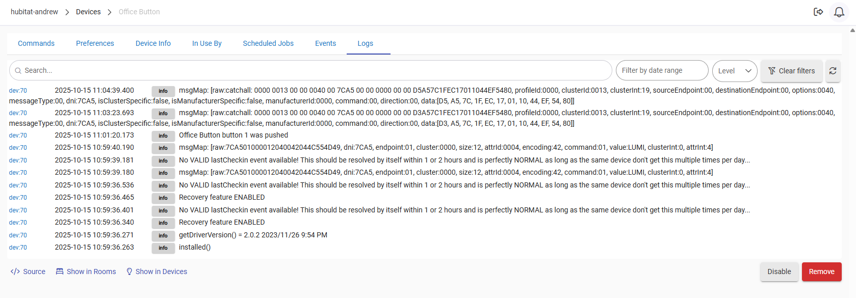

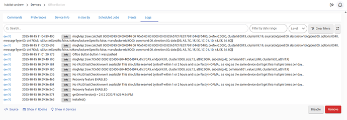

kkosev thanks for providing some guidance here. Unfortunately my issue persists, even when using the community driver and following the pairing workaround. The device pairs but no response is received from a physical button press. I applied the latest device platform update and updated the Zigbee firmware as well, and I tried changing to the stock driver with the pairing workaround. Same results.
Here's the log after following the pairing workarounds and using the community driver:
