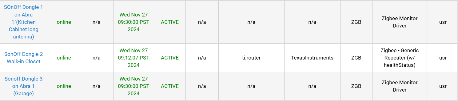

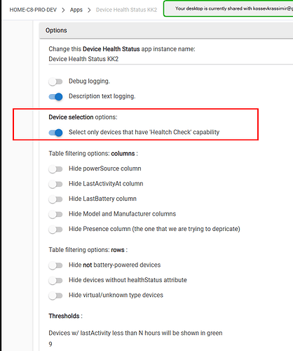

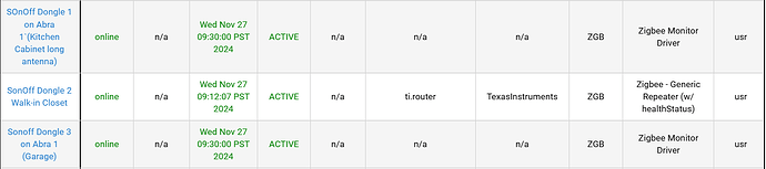

Krassimir - I was trying to add a few SonOff USB Zigbee dongles that I have to your Device Health Status app, but they don't show up in the available devices to add in the app.
His driver does have health status....
24-11-26-1001
24-11-26-1002
Is there something you can change in Device Health Status to pick it up, or ?

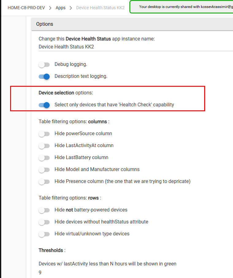

Uncheck this option in the app :
The options page is at the bottom of the app main page.
Bingo! Thanks for the reminder, I sert up the app so long ago that I had forgotten about that setting. :slight_smile:

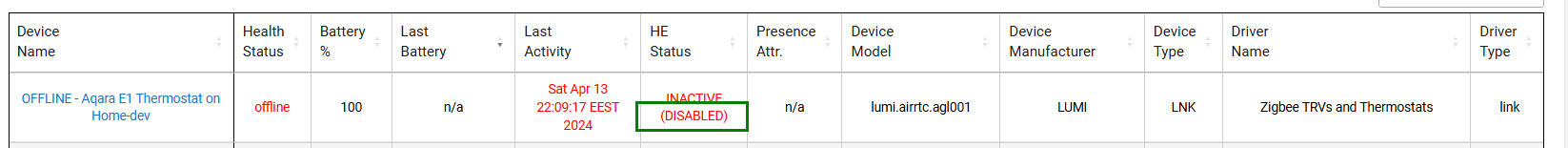

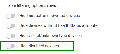

Did this to-do item every get attention? It would be really nice to omit reporting of my holiday plugin outlets that I disable most of the year!
  • Skip disabled devices from being shown in the table.
It is still in the TODO list, just a bit higher priority now... :frowning:
Hoping, hoping, hoping...
Hi John,
Finally, I have pushed version 1.1.1 to be updated via HPM.
  • added lastBattery option (default:disabled);
    At the moment just a few Tuya drivers and some IKEA drivers are using the custom attribute 'lastBattery' time stamp.
  • added hideDisabledDevices option (default:enabled)
    By default this 'hide' option is enabled. i.e. devices that are disabled will not be shown in the table.
If the option is disabled :
then the disabled devices will still be shown in the table, but there will be a (DISABLED) text in the HE Status column :
(I still prefer to keep an eye on the disabled devices sometimes).

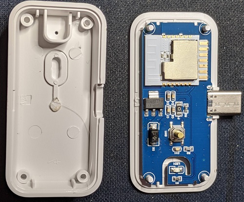

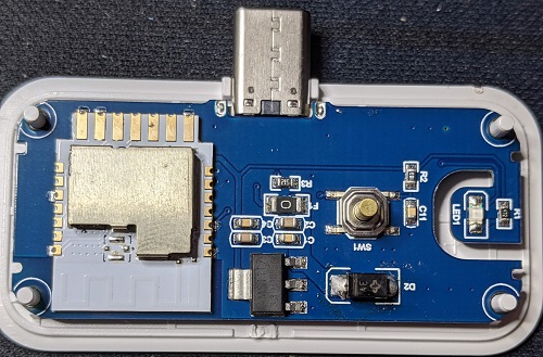

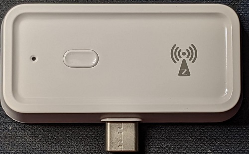

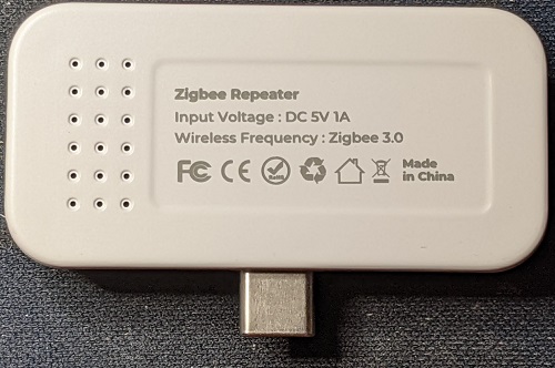

New USB C repeater:
COPY AND PASTE THIS ROW TO THE DEVELOPER: fingerprint model:"TS0001", manufacturer:"_TZ3000_n0lphcok", profileId:"0104", endpointId:"01", inClusters:"0000,0006,0003,0004,0005,E001", outClusters:"000A", application:"64"
And:
Device pairing info
Manufacturer: _TZ3000_n0lphcok
Endpoint 01 application: 64
Endpoint 01 endpointId: 01
Endpoint 01 idAsInt: 1
Endpoint 01 inClusters: 0000,0006,0003,0004,0005,E001
Endpoint 01 initialized: true
Endpoint 01 manufacturer: _TZ3000_n0lphcok
Endpoint 01 model: TS0001
Endpoint 01 outClusters: 000A
Endpoint 01 profileId: 0104
Endpoint 01 stage: 4
Pics
1
2
3
4
6
Thank you for the info. I have added this repeater together with some other manufacturers of similar Tuya devices :
  • ver. 2.0.3 2025-03-01
  • added TS0001 _TZ3000_n0lphcok
    * added TS0207 _TZ3000_m0vaazab _TZ3000_shopg9ss _TZ3000_wmlc9p9z _TZ3000_kxlmv9ag _TZ3000_wlquqiiz _TZ3000_nlsszmzl
