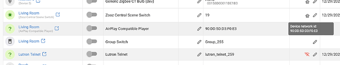

I do have a question mark in the Lutron Telnet device

This just means it doesn't know what icon to show, not relevant.

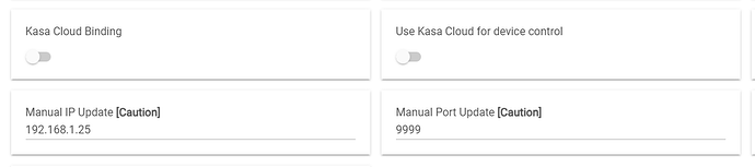

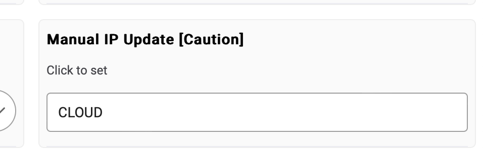

Question - Where to I add the new IP Address in the device page for that bulb?
Here?
If it’s set to cloud mode it t should already work. Did the run the discovery from the integration app like I said?
yes that worked. just wondered if I should list the static IP address on the device
It should have the current IP listed in the data section (on the info tab if you are on 2.4.0 platform). Not sure why yours says cloud, you might be using cloud control.
I have mine set to all use local control only and I removed my login info from the Kasa integration app.
