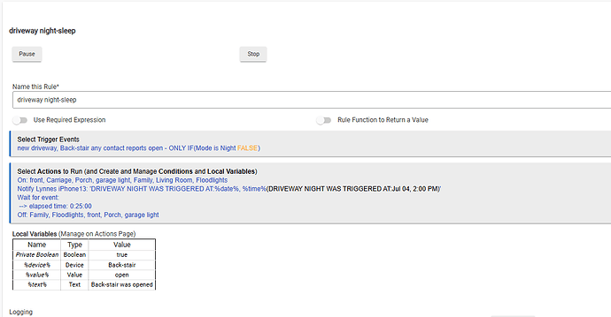

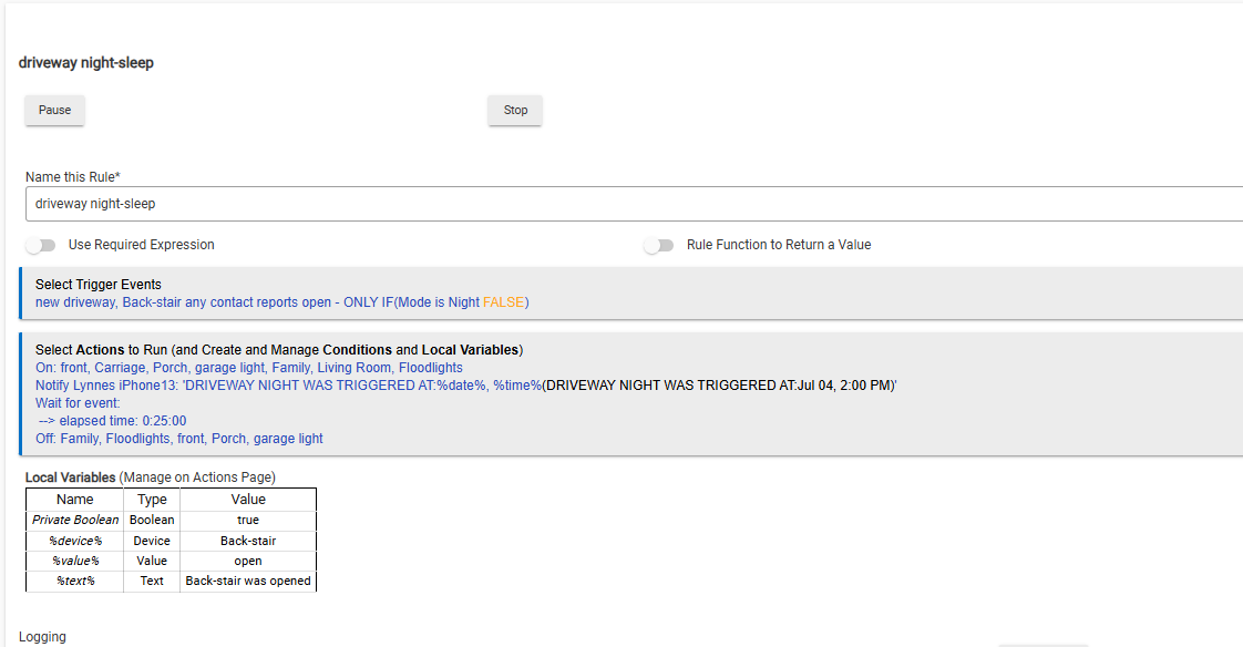

i have a rule that I can't see to get right. It is supposed to turn on the light if someone comes up our backstairs or drives down the drive ONLY if the mode is night. I have MODE as a switch that I tell Alexa at night to turn on nightmode.
I t runs everytime my dog goes outside.
I cant figure out what is going on. Any help would be appreciated
mode is a built in thing and that rule references that not your distinct mode switch. you would have to change your trigger.
Personally I would remove the "ONLY IF(Mode is Night) from your trigger.
Then in your actions I would go.....
IF
Mode = Night
THEN
yours actions as shown.

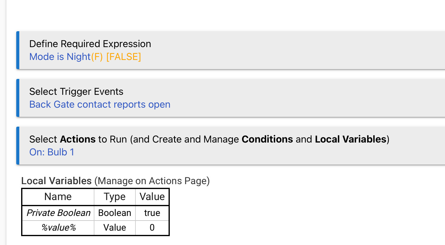

You could also try changing the trigger to be when either contact opens (remove the only if) and add a required expression of mode is night.
Are you saying that you say "Alex turn on nightmode" and it changes the Hub's Mode to Night? Or it turns on a switch named "MODE" or "NIGHTMODE"?
My guess is that the ONLY IF is only being applied the back stair trigger and not on the new driveway trigger.
Even if that's not the case, I would take off the ONLY IF and instead put a Required Expression on the rule for Mode is Night.
I’ll second this suggestion. a Required Expression would be ideal in this scenario.

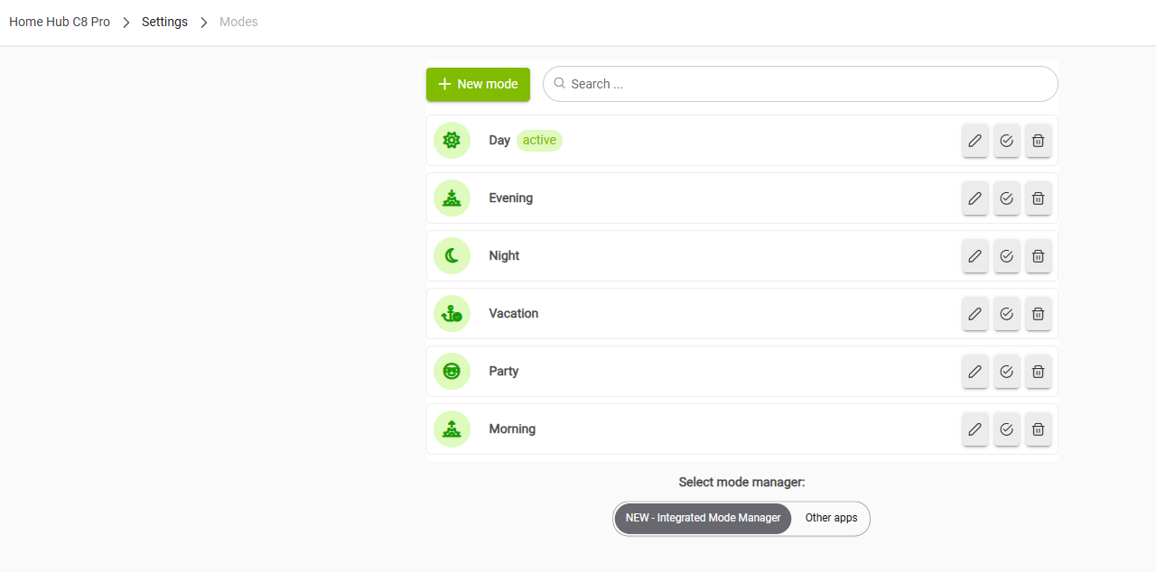

If you going into settings/modes and active night (click on the check mark) does the rule still show false?
the mode part works great. I deleted the old rule and made a new one with REQUIRED . Rught now that seems to at least node turn all the light on every time the dog goes out! Ill try changing the mode to night and see if it triggers.
