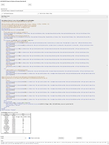

I have a Rule that sets individual LEDs on 4 Inovelli Blue dimmer/switch units to have a daytime set of ON/OFF colors, and a nighttime set of ON/OFF colors. The IB units seem to take a bit of time to make individual LED changes, so I've padded the rule with explicit delays of 3 seconds between moving on to a next LED. The Rule actions are called by a scheduling rule, so it has no explicit trigger.
I've also found that it sometimes takes the IB units a few tries to get set to a new LED setting, so my Rule repeats the actions 5 times, with an original repetition period of 30 seconds.
The Rule (image of current below) has generally been running fine for some months, but in the past week I've gotten hub messages about the 4 IB units using a lot of hub resources (and HE response has become glacial). Looking at the Rule, it shows as "Repeating". I initially thought that the loop was repeating before all of the delays and actions had completed, so I increased the repetition period to 120 seconds.

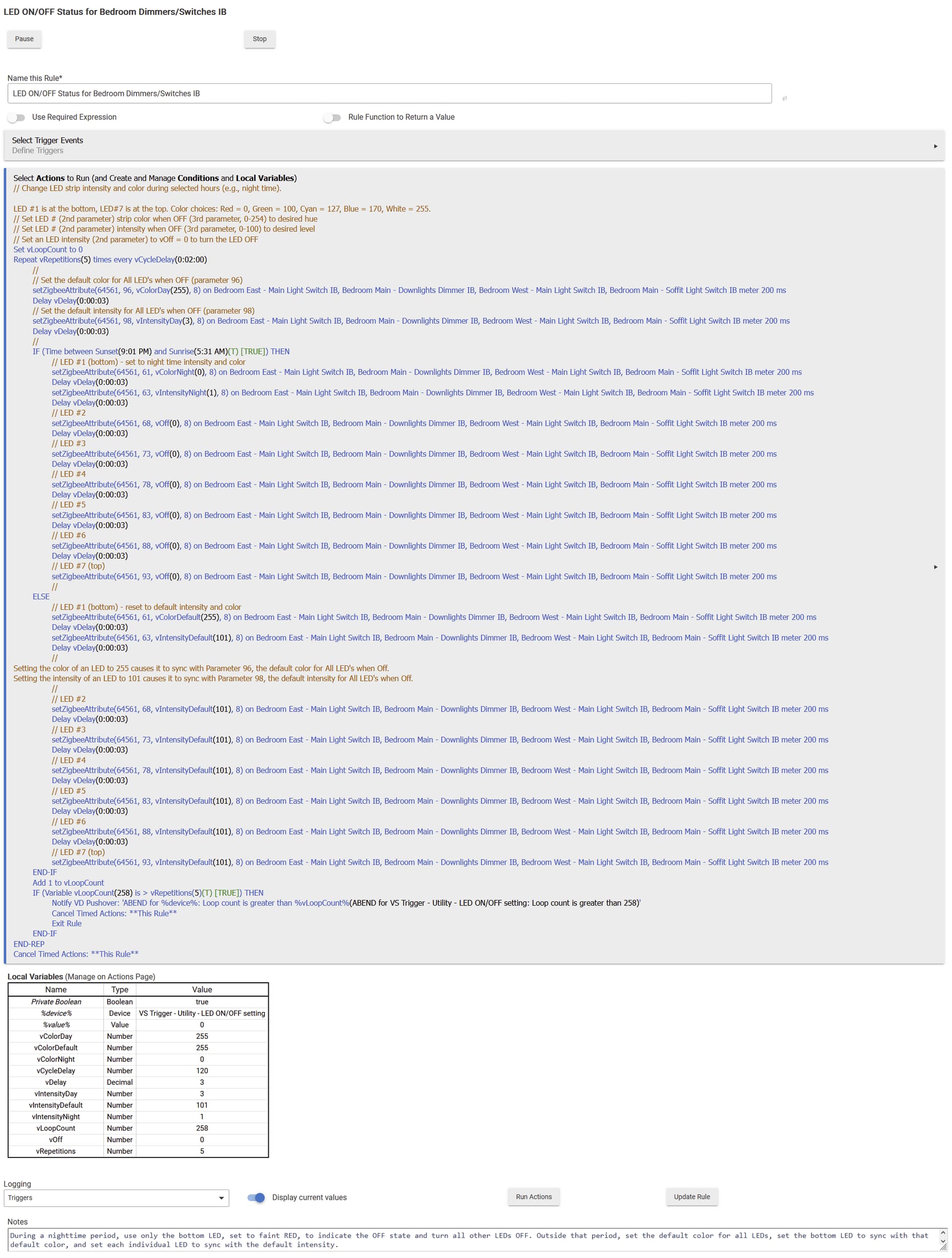

I was still getting the hub message re resource usage, so I added a loop counter (vLoopCounter), and tonight found that the loop was at 258 cycles (rather than 5) before I killed it. Accordingly, just tonight, I've added an IF action to exit the Rule if the loop counter is greater than 5 (so the Rule image below has that new IF action).
Am I misunderstanding how the "every x seconds" aspect of the REPEAT action work? Or is it broken? Or am I trying to solve this problem in a very awkward way?

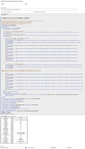

What does the scheduling rule look like?
Looks like you don't have logs turned on for actions.

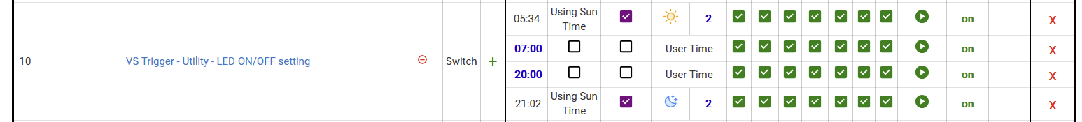

Here's the Rule that runs the problematic Rule (as well as 3 similar Rules that are NOT exhibiting the REPEAT action problem):
The "master" rule is in turn triggered by an entry in the Schedule Manager app:
I didn't have Action logging turned on while operation was normal (i.e., REPEAT stopped after 5 tries). I will turn it on for the next few days.

It may be that you are right that doing BOTH "command retry" and Repeat is causing congestion. For now, I've kept "command retry" enabled, but I've increased the delay between individual LED setting actions to 10secs and that seems to be working. I did turn logging back on, but I have not seen any indication that commands are actually being retried.
More fundamentally, I'm still not clear on why the Repeat action never stopped.
However, I've built in a conditional that forces a loop exit if the number of passages through the loop exceeds the defined number of repetitions, and also instrumented the loop and the entire Rule to determine and report on the amount of time required to run the Rule and one passage of the loop.
