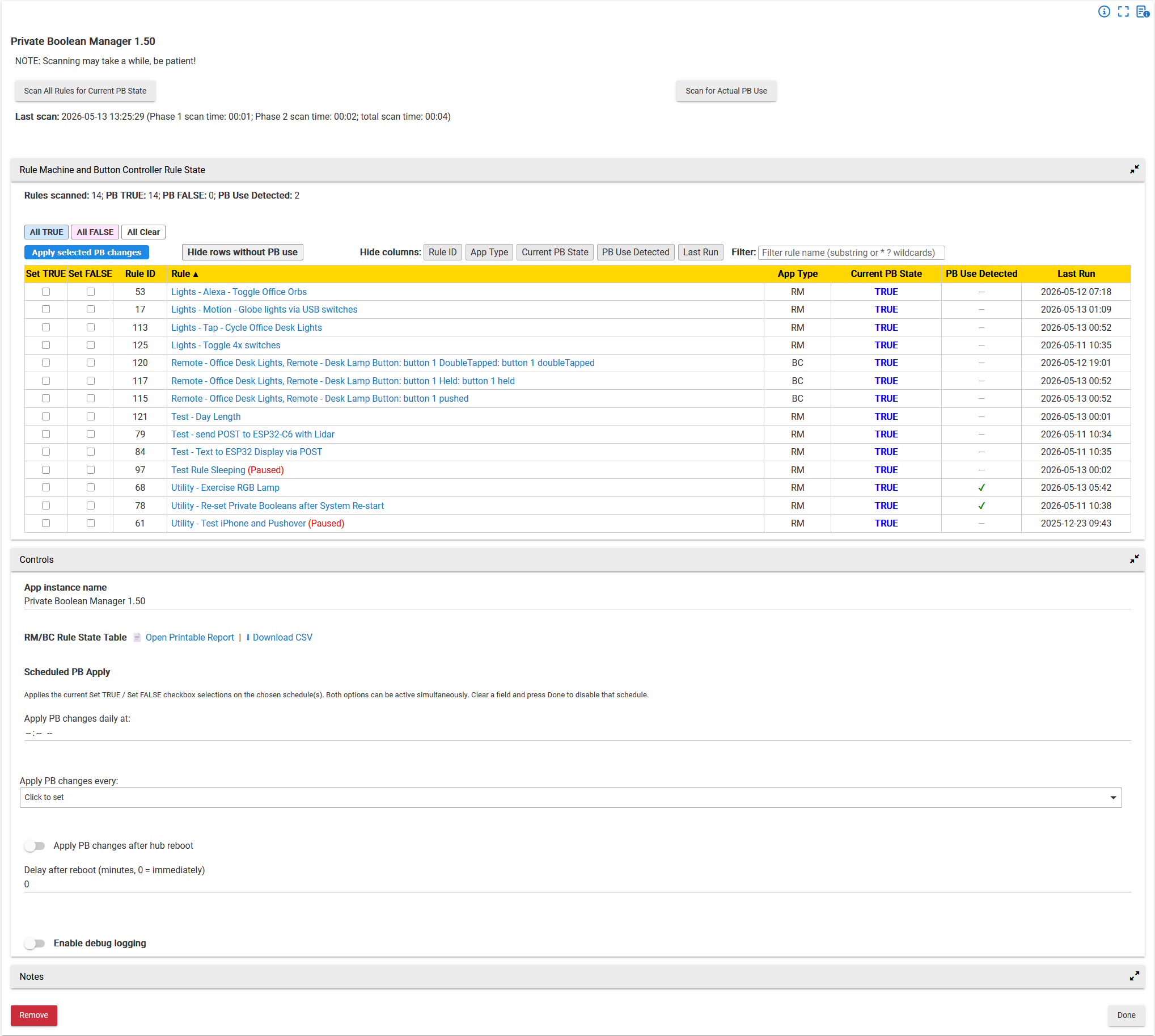

This BETA app has two functions: it scans Rule Machine (RM) and Button Controller (BC) rules and displays their current Private Boolean state and Last Run time in a table; and it lets you bulk-set Private Boolean values across multiple rules at once. The TRUE and FALSE settings persist if saved by clicking "DONE".
I wrote this app because I have seen Private Booleans used as flags to control re-triggering of a rule be left in a FALSE state for whatever reason. This app helps you find and manage those wayward PB's.
You can also run the app at a specified time to set the PB state of rules that have had their Set True and Set False checkboxes saved.
NEW 2026-05-11: The app can now detect which rules actually use a Private Boolean (all rules have PB's but not all rules use them in conditions, triggers, and actions).
NOTE: this function can take a LONG time with a lot of rules, particularly if the rules are lengthy; for 303 rules on my main hub, the total scan time ranged between 8 and 11 minutes, whereas a simple scan for current PB state ran only about one minute.

There was a bug in the App instance name control and the ability to install multiple instances was set wrong, both now fixed in v. 1.43 (see link in Post #1). You should be able to install multiple instances now, and rename each instance.
You can now set Scheduled PB Apply every 1, 2, 5, 10, 15, 20, 30, or 60 minutes. Claude AI suggested that control and I'm not familiar enough with Hubitat Groovy controls to know of a more flexible one (e.g., "every 127 minutes").
