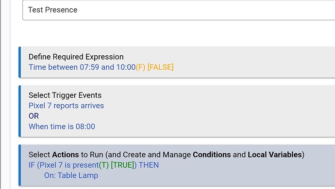

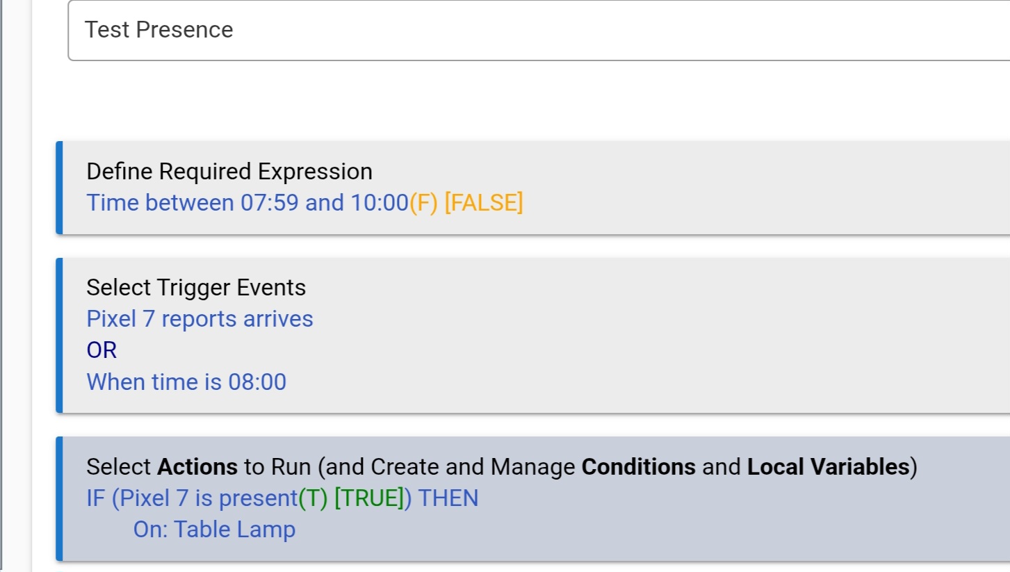

I have a rule like this. It has two triggers, one is a conditional trigger set at a specific time (8:00 am in your case) only if (the presence state you want) and the other trigger is on the event.
I think this will do the job. Note that I set the required expression to be 07:59-10:00, to make sure the rule will trigger at 08:00.
The actual rule is also dependent on the day of week. I don't turn the switch on every day.

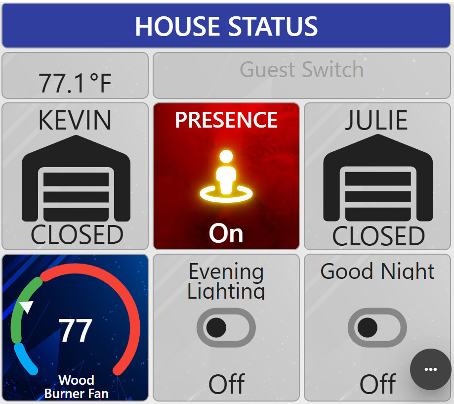

Create a Virtual Switch. Mine is "VPresence". When ANY of 3 devices arrive, it will turn ON. When ALL of the devices leave it will turn OFF. If you arrive Thursday and are still there on Saturday, the switch will still be ON. Condition your other rules using this switch.
