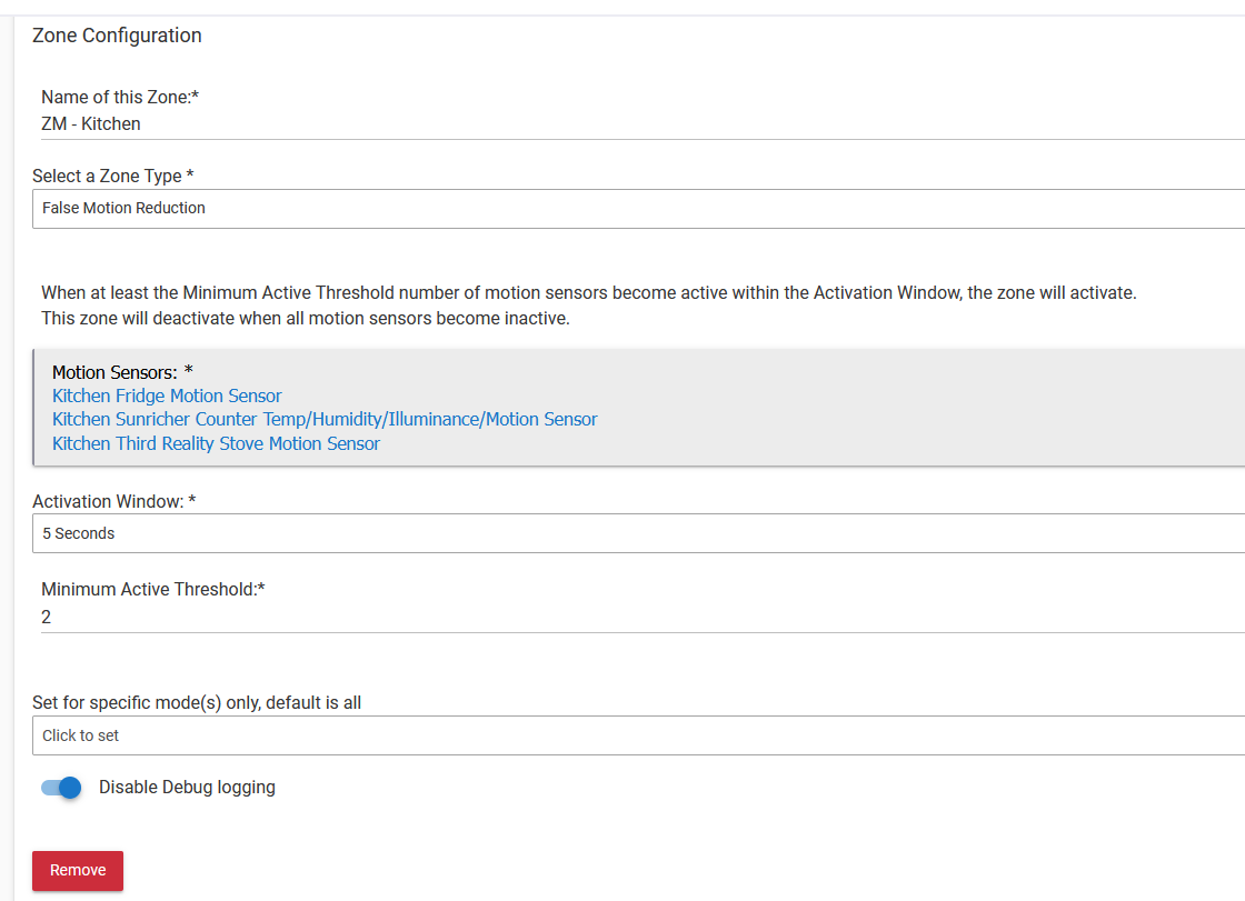

+1 on Third Reality sensors. I use a 'team' of them - I have 3 because my kitchen is oddly shapped - I then use Zone Motion Controller App:
Then as posted above, I just use Room Lighting to get the final result. I also have a 2ndary trigger off when motion detected in another room.
