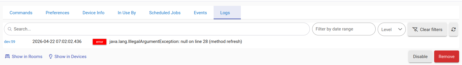

Power Aggregator Driver IllegalArgumentException: null on line 28 (method refresh)
my Power Aggregator device hang with an IllegalArgumentException: null on line 28 (method refresh) right after midnight!
I have done the test many times by aggregating one device or more. it happen no matter how many devices are aggregated. sometimes it happen in few hours other times after few days but always few minutes after midnight.

When the device hang, it disappears from the aggregated devices under Power Aggregators App

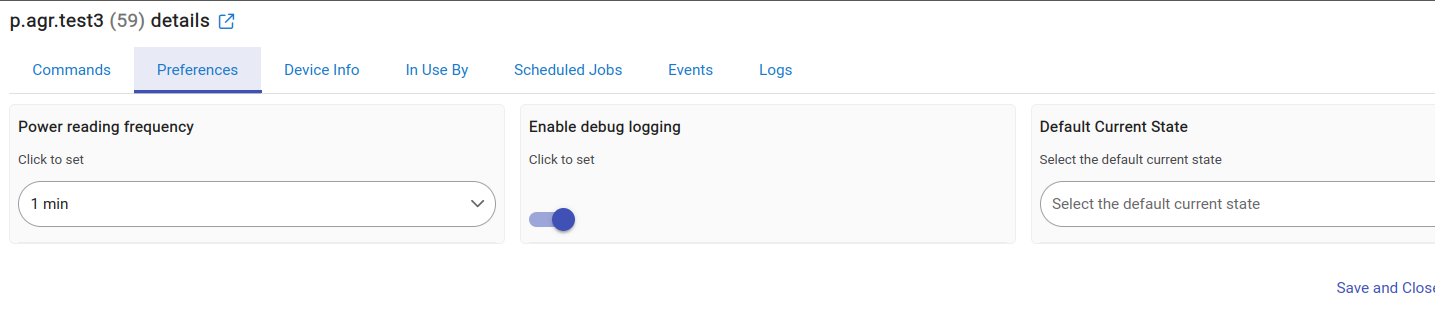

power aggregator device properties :
