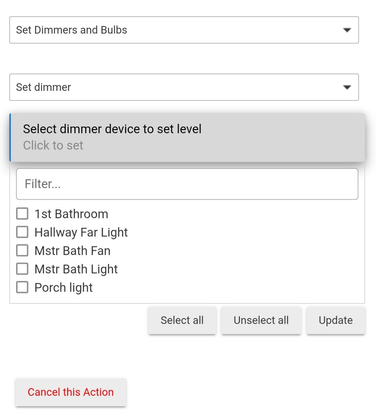

Is there a way in the rule machine to set brightness on a variable device? It is not in the dropdown.
I'm a bit confused on what you're trying to do: are you trying to set the value of a hub variable, or are you trying to use a variable as the brightness value in a Rule Machine action like you might do later in your screenshot? Both are possible. But setting a hub variable is under Set Variable, Mode or File, Run Custom Action, not Set Dimmers and Bulbs (although you technically might see it there if you made a connector of a matching type, but in Rule Machine, there's no reason not to jist working with the variable directly).

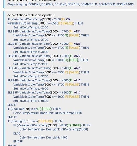

Depending on the current color temp, a press of the button increases (or decreases if the other button is pressed) the variable "intcolortemp" in steps.
Once the variable is set, I adjust the light to the variable color temp value. This should work for dim levels as well.
(The last two If/then blocks cause it to only adjust the lights that are on. One of the lights is limited to 4000. So, if the variable is > 4000, it sets it to 4000).

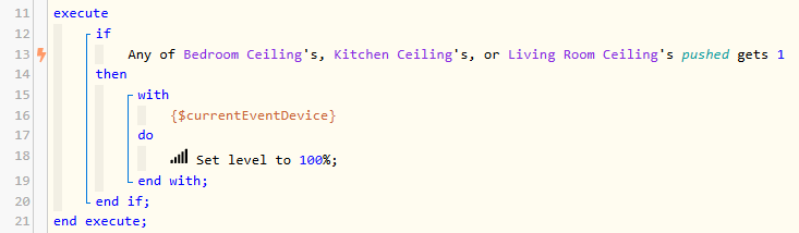

I would just use $currentEventDevice in Webcore.

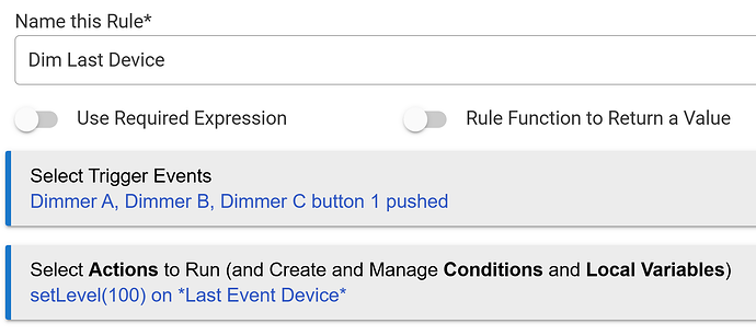

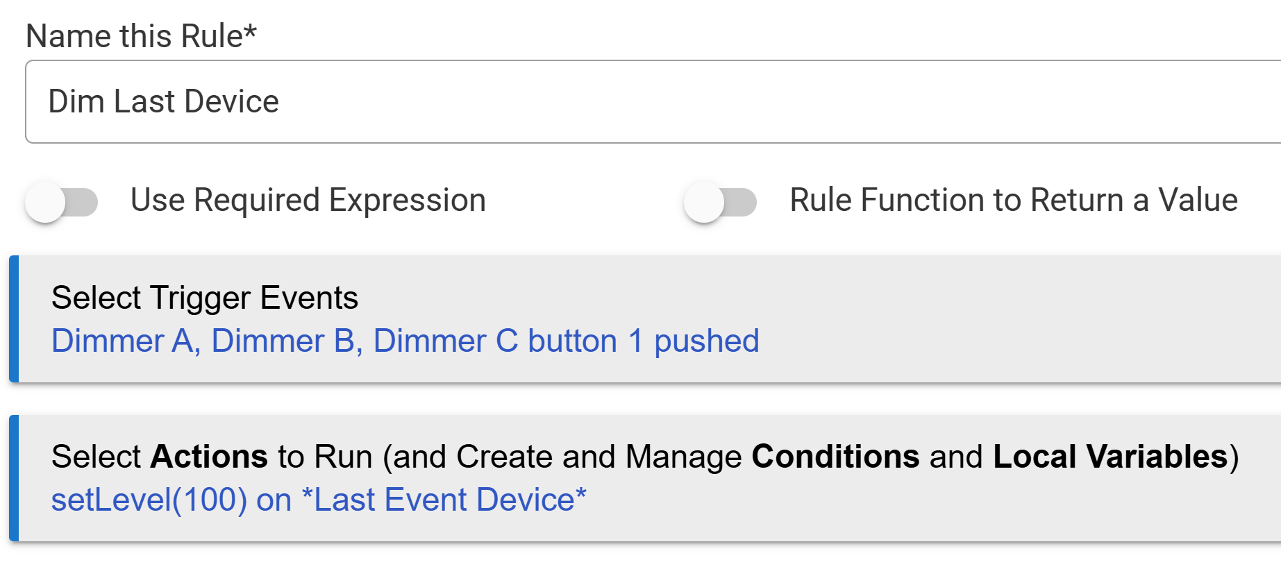

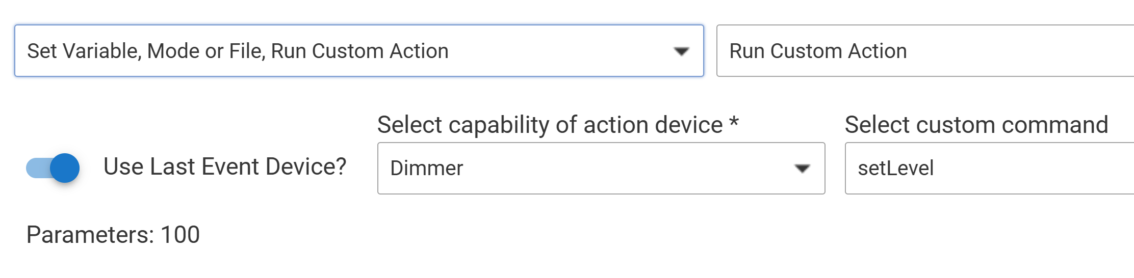

Try Custom Action:
Yes, you can do this in Rule Machine, using the Last Event Device toggle under Run Custom Action. Here's the basic setup:

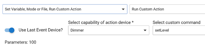

...with a close-up of the Action needed:
Ah yes! There is always more than one way. $currentEventDevice.....Good Choice!

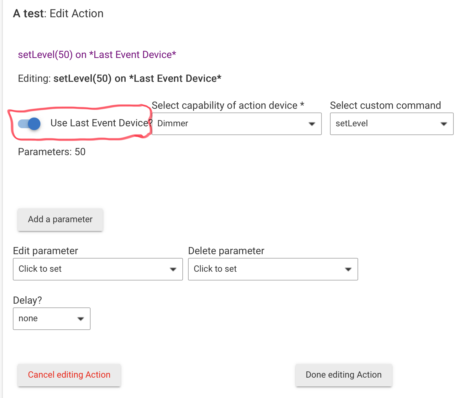

One can never stop learning. I had not noticed the Use Last Event Device. Now I need to find a reason to use it!!
Important caveat: This technique only works if the trigger/target devices' driver(s) offer both the buttonPushed (attribute) and the setLevel (command). So, for example, if you attempted this same rule using devices assigned the Virtual Button (no dimming) or Virtual Dimmer (no button) driver, RM would be unable to complete the Run Custom Action, due to a feature missing from each.
I fear such nuances of RM's "hidden-yet-powerful gems" (like Use Last Event Device and Run Custom Action) keep even seasoned rule-makers from finding them or using them to their full potential.
