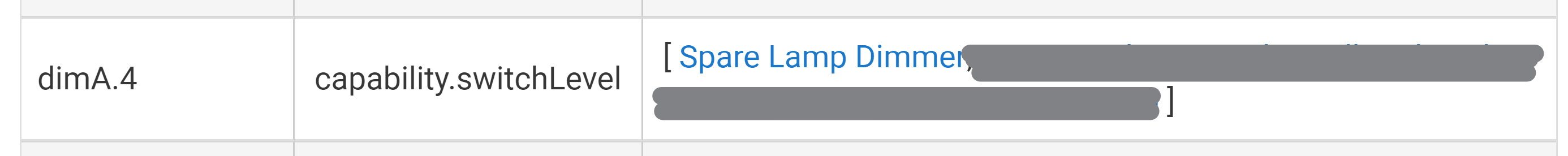

Spent two days trying my best to remove (and ultimately exclude) an older Z-Wave dimmer which insisted it was still "In Use By" both RM5.1 and Z-Wave Poller. It wasn't.
And despite having (1) painstakingly delisted the Device in both apps, (2) rebooted the C7 hub, (3) STOP/START'ed the RM rule, (4) Update/Done'd the rule, and finally (5) Refresh/Configure'd the Device from its Detail Page, the Device name still appears in the Gear table:
Figured I'd ask here before force-Remove'ing the device. Then took matters into my own hands, LOL...
PROGRESS: By Clone-ing the stuck RM5.1 rule, and swapping in a different device for the stuck Device, then deleting the old copy of the rule, I managed to release it from RM. Will undertake similar maneuvers with Poller app. (Edit: Yep, uninstall/re-install of Poller app - which cannot be Clone'd - cured issue.)
