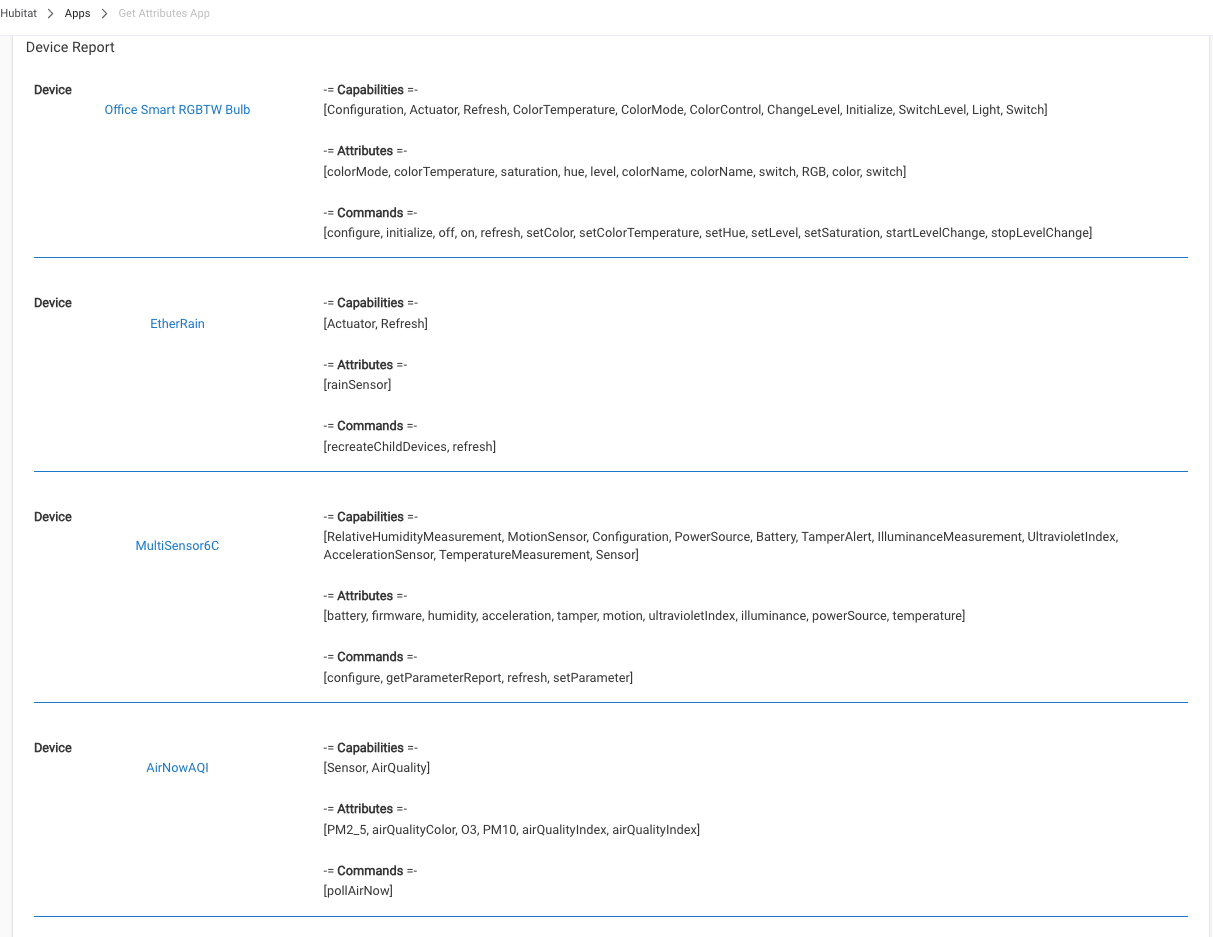

Technically speaking, every driver should be either an Actuator or a Sensor. You can use GetAttributeApp to display Attributes, Capabilities and Commands for one or more devices. I have found several Hubitat built-in drivers that are missing them, but of course no driver has none.
