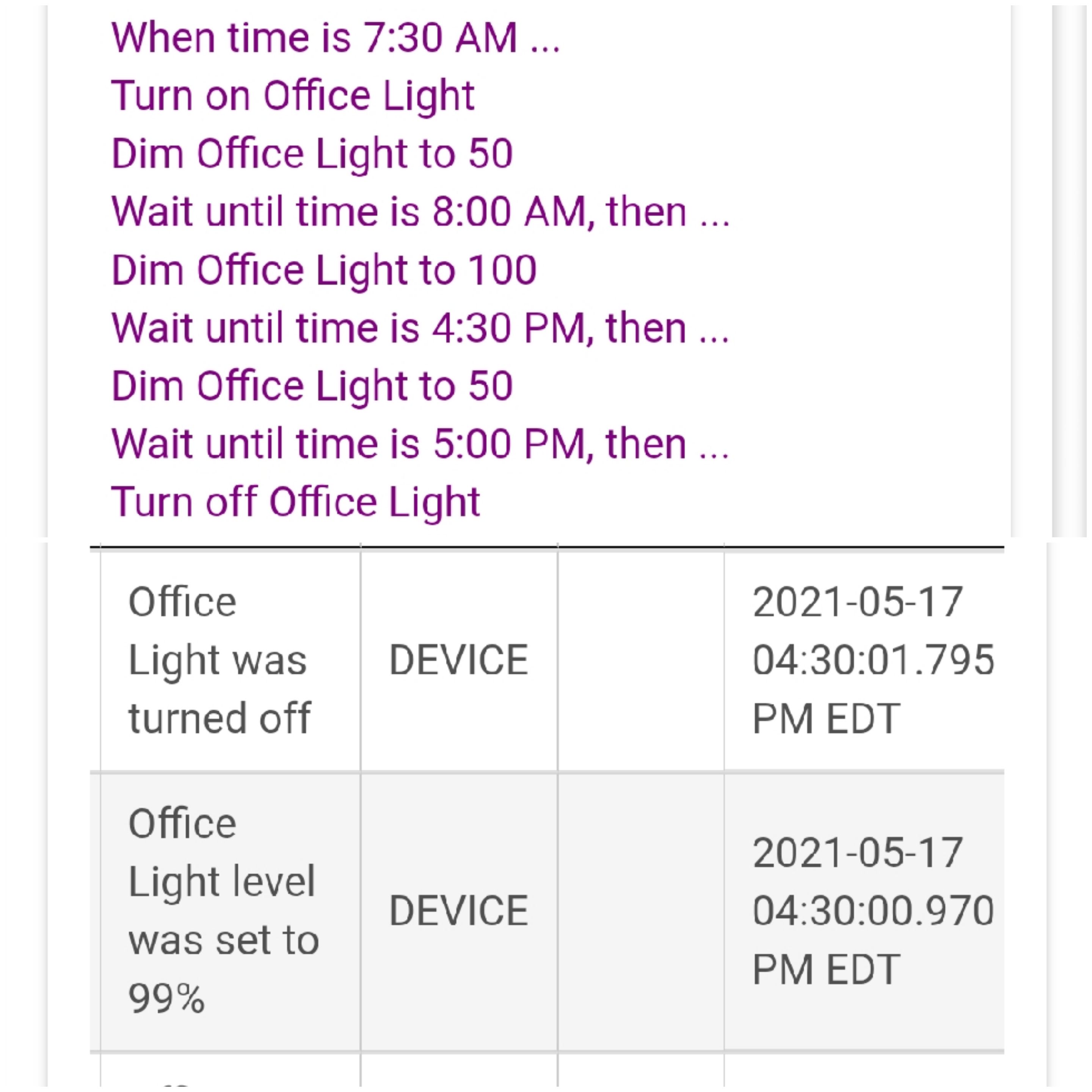

Similar to a recent thread I posted, today my Office light basic rule misfired.
In both cases, the light involved is a Zigbee Sengled Element Classic bulb.
The rule came on at 7:30 AM at 50% and switched to 100% at 8:00 AM
At 4:30 PM it's supposed to drop back to 50% and then turn off at 5:00 PM.
Today the light turned off at 4:30 PM instead of dimming.

Please turn on logging for both the device (Description text logging) and the rule.
It would be helpful to capture a screenshot of the rule's App Status page at some point between 8:00 AM and before 4:30 PM.

Here is the rule status screen after 8:00 AM
Light schedule worked as expected today.
For the last two days (24th & 25th), the light has turned off at 4:30 PM instead of dimming to 50%.
Here is the log events from the 21st (when it worked as expected) and 24th where it didn't work.

Here's the 4:30 logs.
I have no idea what's going on here.
I don't either. Remove that rule and recreate it. Next time, post logs by screenshot, not copy/paste.
Swapped out the text for an image.
