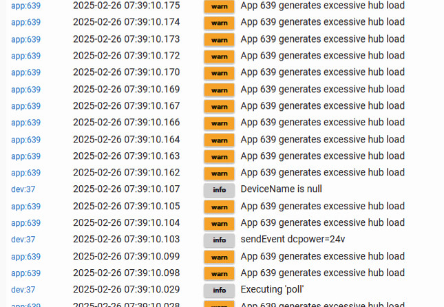

Polling 2 devices every 5 seconds
So I have a lot of devices, most of them on my 2 dashboards that are visible on tablets around the house, so I need to konw their states...
Some of them don't report correctly (Shelly devices), even though I've tried everything possible, so I've figured out that I can periodiscally poll/refresh these to get my states correctly...
I've ben polling 2 devices every 5 seconds, but I now have "App 639 generates excesive hub load" warn in my logs and this gets reported 40x plus per second...
Is there a workaround to my workaround? How do I stop exerting my hub in order to get two devices data somewhat "live"?

@DrRomca - What exact driver are you using for the Shelly devices? Also, what command are you calling every 5 seconds? Can you post a screenshot of the rule or alike you have setup to run every 5 seconds?

Sorry, yes, it is the Rule Machine with very simple rule:
Thanks, It is that app, yes. And I've tried to change it to 10 sec as it is still somewhat usable. Still the same outcome...

However seing all the possible causes of this now, I've connected to my Hubitat from here and deleted the rule, then created the same rule again and there are no issues now...
It's been up nearly 5 minutes with no warn so far. Before there were 40+ warns a second...
It appears to be solved for now!
