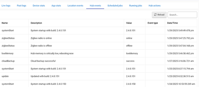

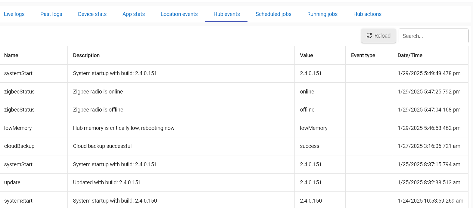

Basically the hub will come to crawl every 4-5 days unless rebooted. But there has not been anything in the logs or Device/App stats that I have been able to trace to a particular app/device causing the issue. So I was hoping @bcopeland or someone could take a look at the engineering logs incase I am missing something.

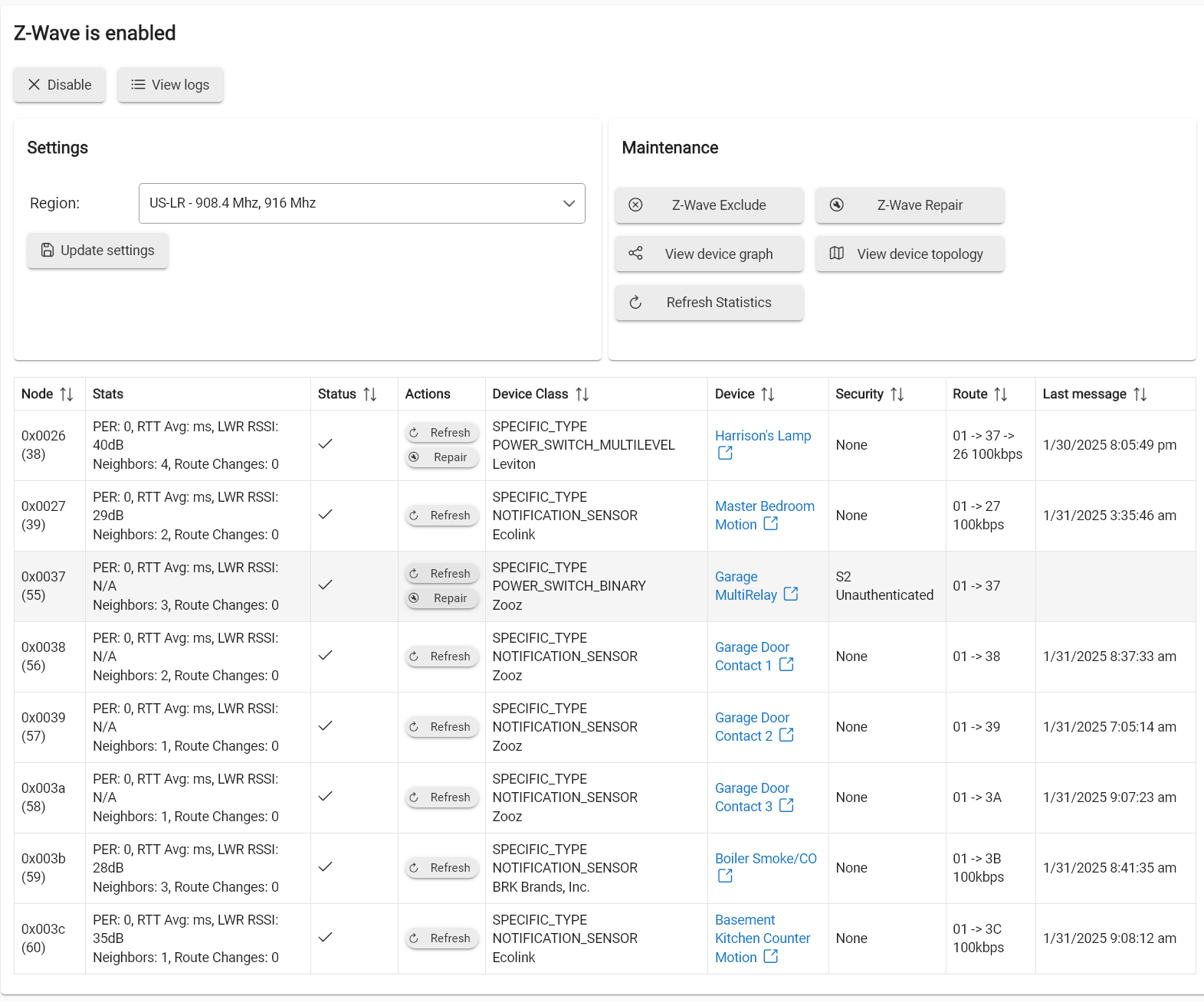

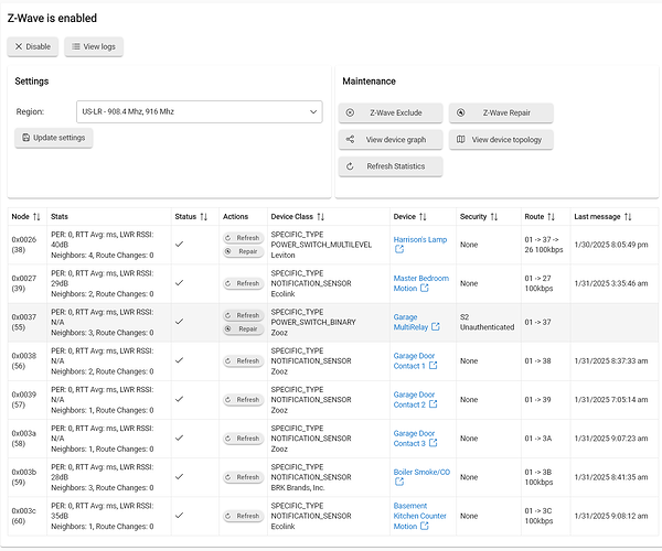

What platform are you on? Install @thebearmay 's Hubitat information driver and monitor the memory to see if it's leaking. Have you done a database rebuild? What does your z-wave details page look like (post it in it's entirety using windows snip)
The free memory at the time of the hub claiming critically low memory was around 280MB, which didn't seem low to me. It seems to hoover around 300MB free most of the time.
