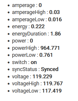

I have one on my front loading washer. I watched most of a cycle, on and off, lol, one time. The load varies a lot as it changes direction, speed, drain, etc. I have no logs of a recent run, because it's mostly off, I guess lol.
Below is a recent screen shot. I turned off all reporting except watt, but it looks like 1000 watts is max, which I seem to remember. Now bear in mind, there's a good chance that's due to motor startup. Perhaps newer washers have different motors that don't have as much inrush current.

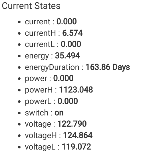

I just checked my Zen15 for it's min max values similar to what Velvetfoot posted. It is below:
It is really about that High value right. In my case my LG Washer has hit over
1100 watts. It doesn't do that very long. Most like in the final high speed spin to remove as much water as possible.
You also need to keep in mind these power reporting values are based on settings right. So a momentary spike that only occurs for a few seconds may not be captures depending on those settings.

164 days. Impressive.

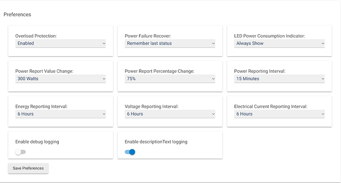

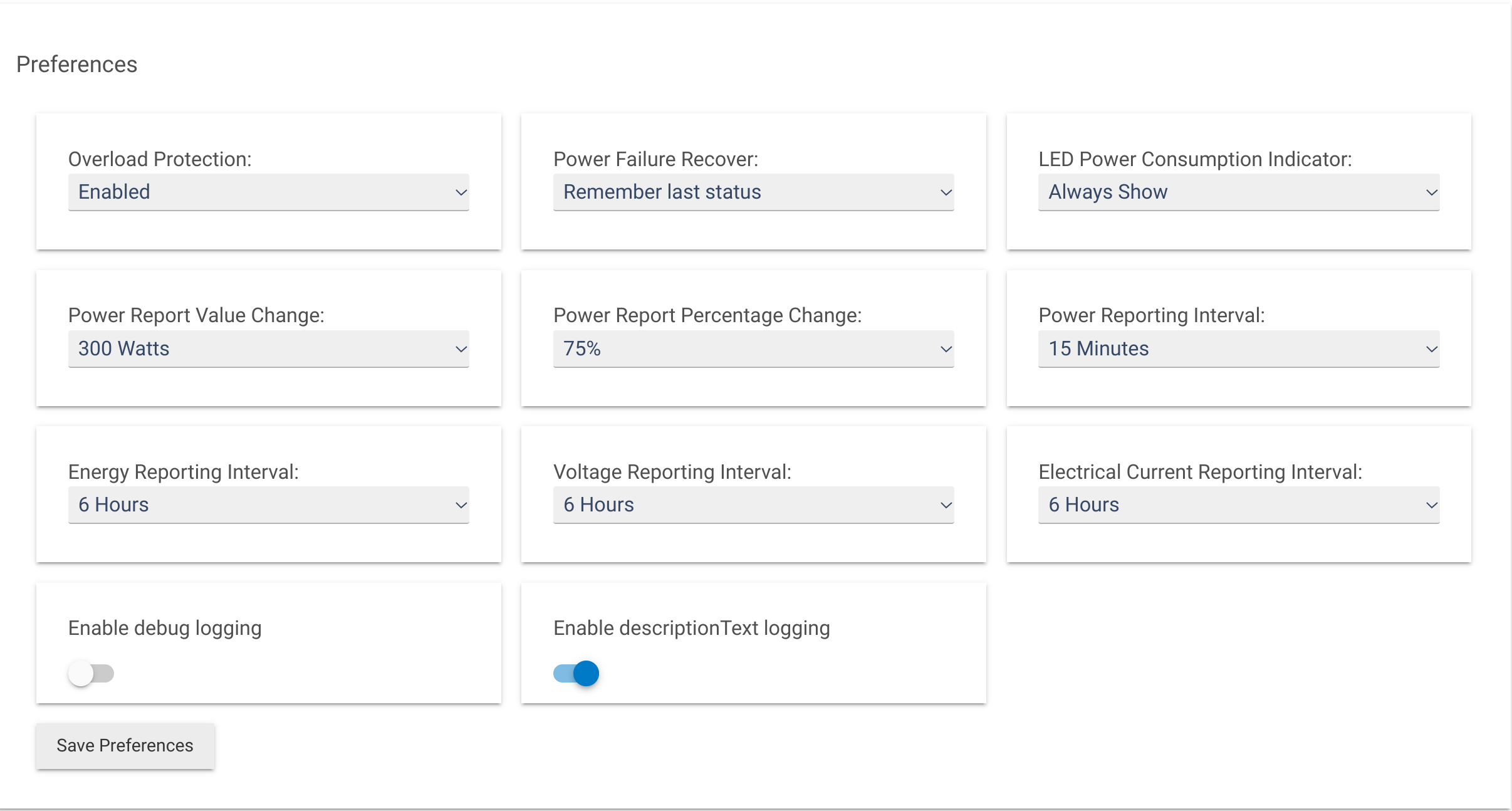

@mavrrick58 , can I ask you what your settings are on your Zen15? I'd like to get the other units involved, not just watts, but I don't want to overdo it on the reporting. Thanks.
Here are the settings I use for my Zen15.
I could probably be a bit more conservative to reduce the load on the Zwave network, but this seems to be pretty good.

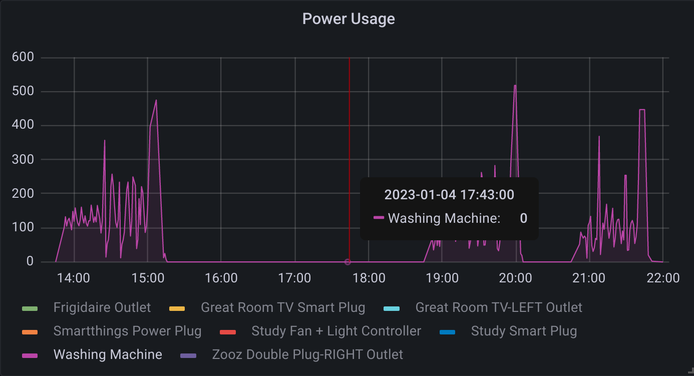

It is still capturing a fair amount because of how much the power draw fluctuates. Here is a graph from grafana where you can see how it changes during a load. Allot of ups and downs. This is a front loading LG Washer by the way. It looks like we ran 3 load of laundry that day.
Thanks. Nice graph. Again, maybe one day.

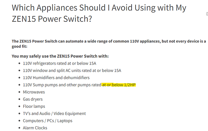

A ZEN15 doesn't have the specific markings on the plug, nor in the tech specs, but they do have in the documentation elsewhere that it's alright on a 1/2 HP load:
All this to say...I would wager any plug rated for 15A from a respectable manufacturer would probably be alright. I would not go grab the first $5 plug on Amazon and use it though.
