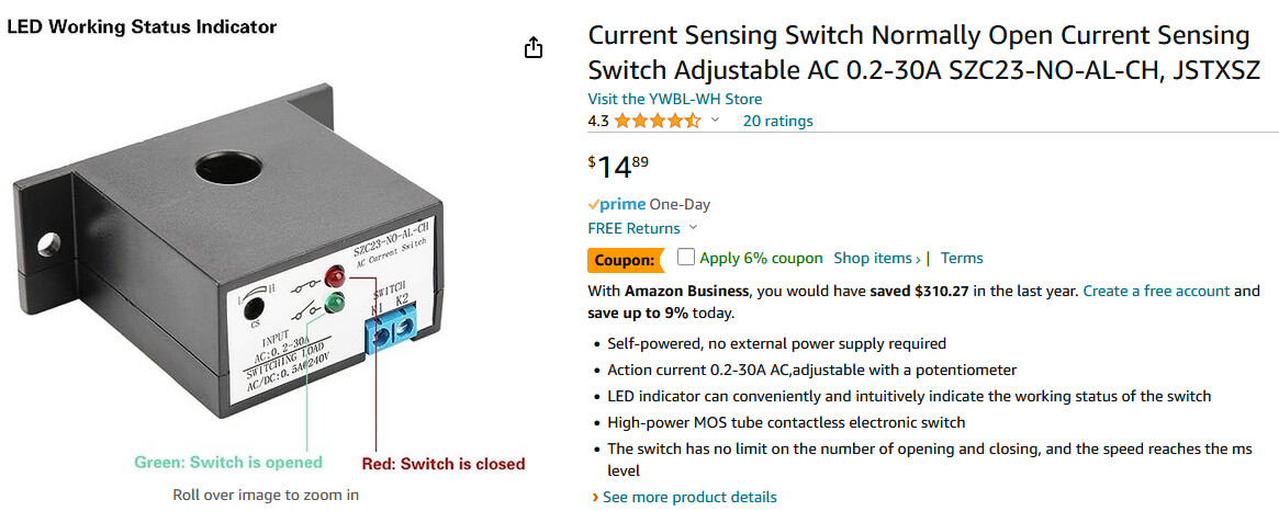

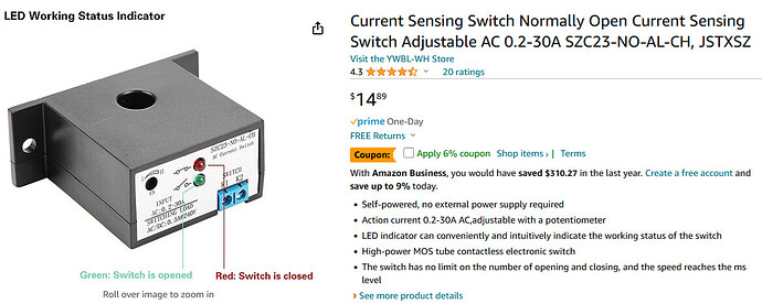

I’d imagine you could cobble together a solution with a non-smart current detector (like this one at https://a.co/d/1OHluSK) and a Zooz Zen16.

A power monitoring outlet is a smart choice.

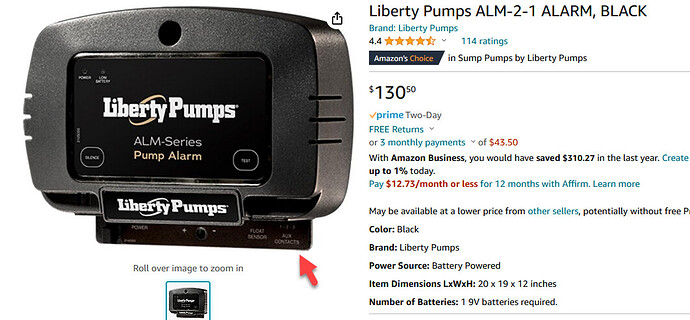

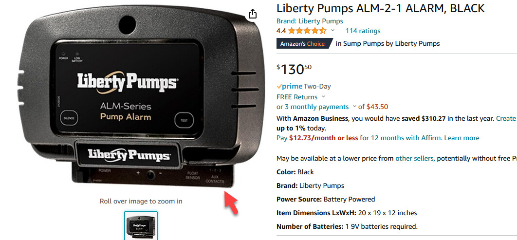

I just did this kind of thing with a sewage ejector which is similar to a sump pump. You have some other choices.
Use a contact sensor of your choice wired to a dry contact sensor like the below. These sensors are not powered so you can safely use them. What I have done in the past is wire them with a short extension cord. You can then move it around to whatever you need to sense.
I use a liberty float alarm that has a dry contact. I wired this up in a way that I can alert with a zigbee contact sensor and a flo sensor toshut off my water using a Flo.
Would that device work with a 240v 2-leg (USA) cable, vs. 120v?
Cool device.
The way these work is you only put the load wire through them. So, yes, it would work with two legs because you would just need to put one leg through it.
I thought so. You'd have to split the wires.
Yes, in all cases.
