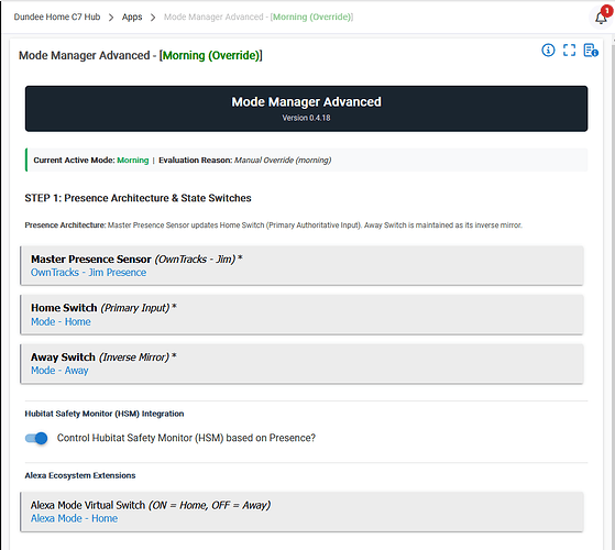

  • I wanted HSM to follow my Mode respecting presence automatically.
  • I wanted to define the Presence sensor(s) that control Home/Away.
  • I wanted to control my Alexa state for guard etc directly based on my Mode.
  • I wanted to not need to have rules be concerned with managing Modes other than normal Conditions or triggers.

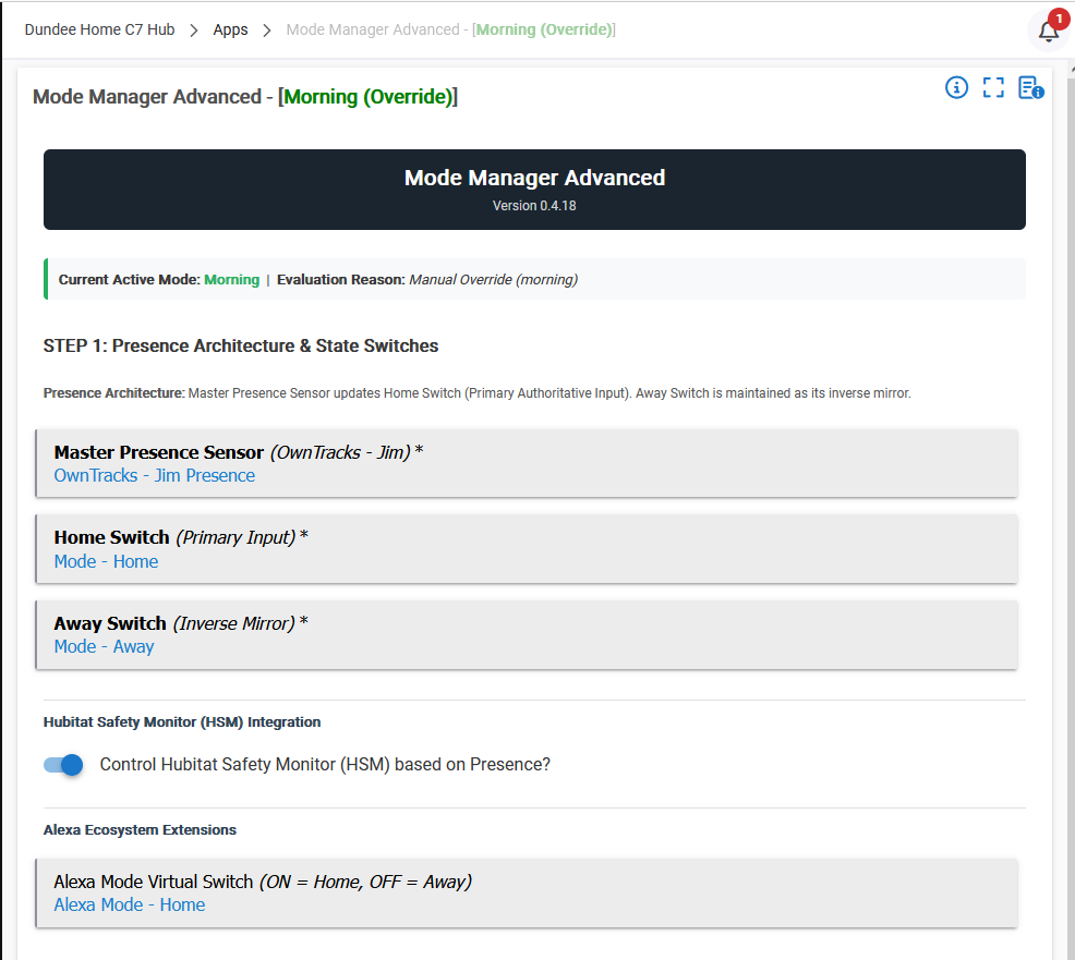

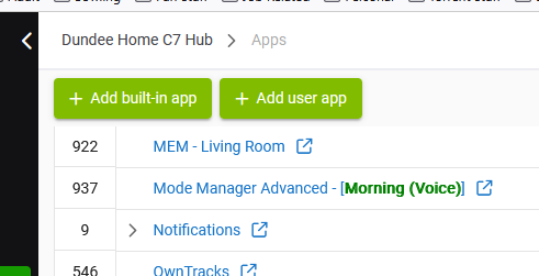

Mission accomplished! Now, if I leave or come back, my presences sets the mode correctly, tells me why it set the mode, turns HSM off, and tells Alexa 'home'. No rules required.
If I manually set a mode via switch on the dashboard, that mode enables AND it tells me I'm in Override mode (until I trigger the recheck).

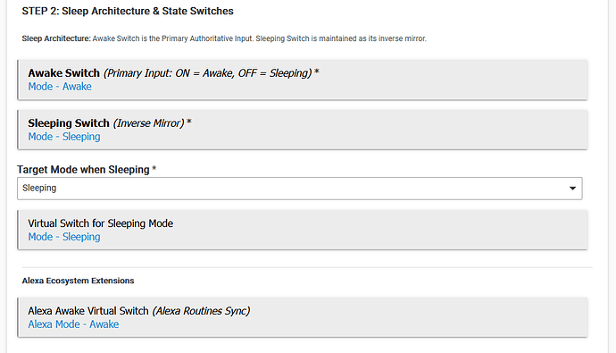

When I tell Alexa I've gone to bed, the whole system switches to sleep mode (and lets me know it was triggered by Voice)
Here's my management screen (in step sections so its nicer to see)

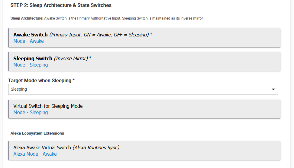

And the Sleep section -

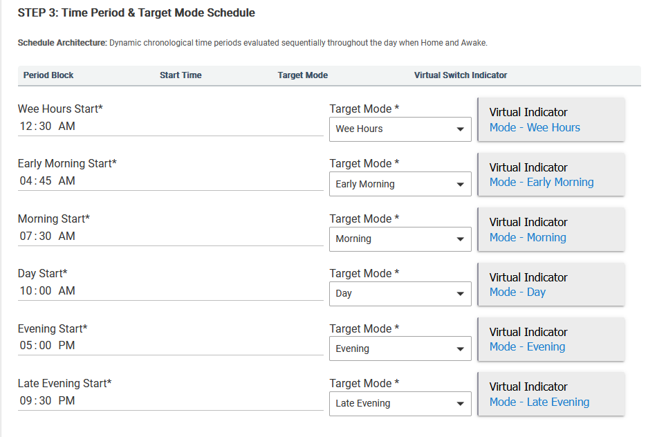

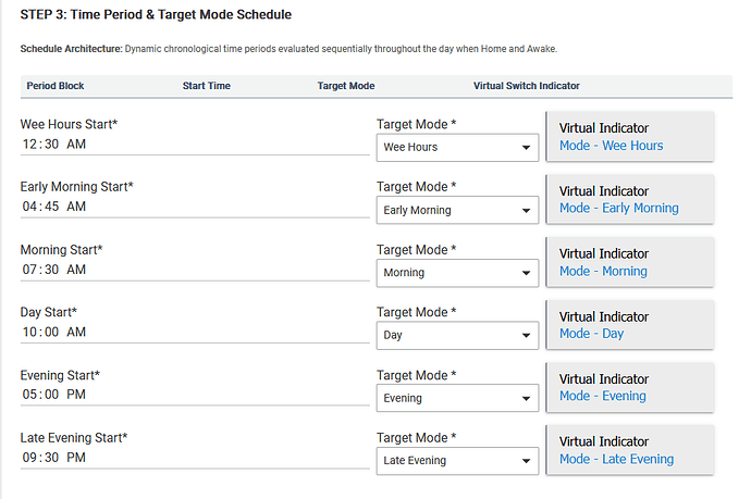

The Time Period section:

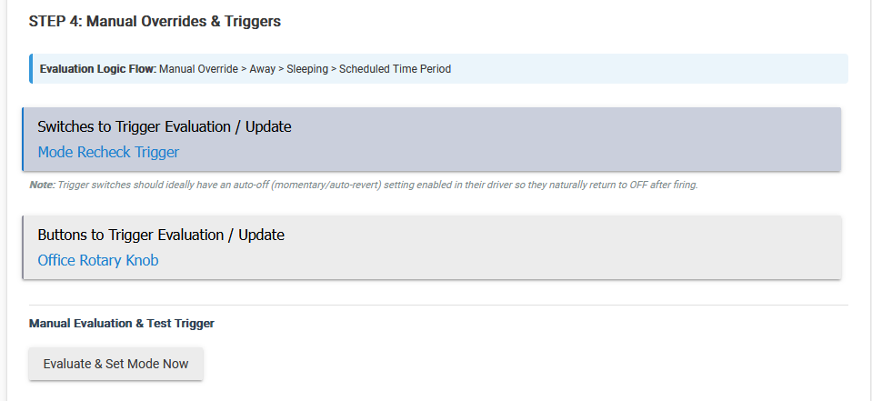

The Overrides Section

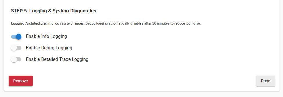

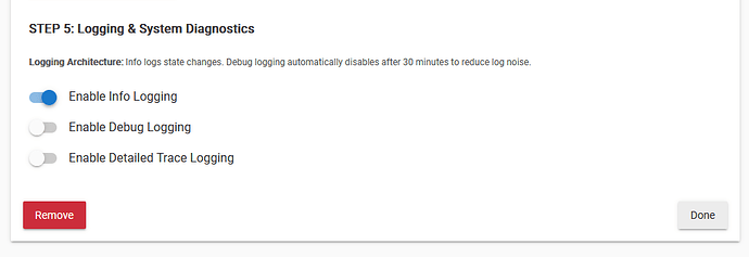

And of course the logging section:
