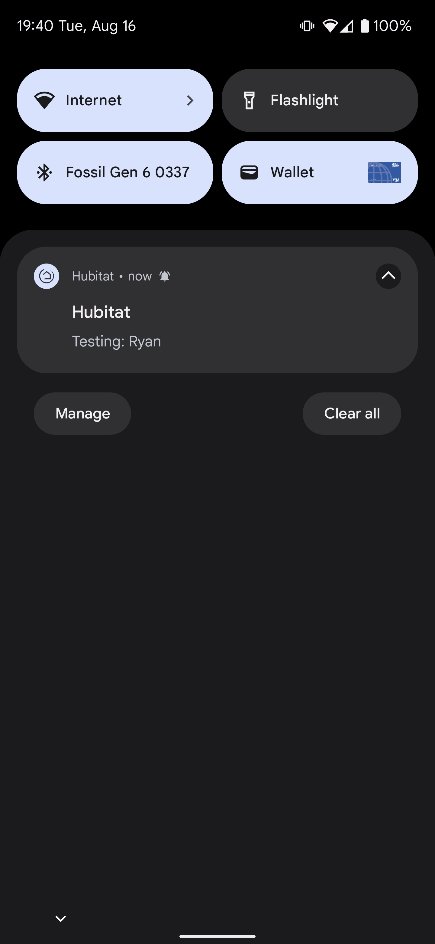

I have a virtual keypad that utilizes Lock Code Manager. I can't for the life of me figure out how to set up notifications based on names of codes. I've done some searching but everything seems to be different than what I am experiencing.

You can check the logs/device events for what shows up when you enter a code on the keypad. I just can't tell if that's going to show up as a button pushed or what. From there, you can write an action to notify your phone of the value for the lock code entered.
