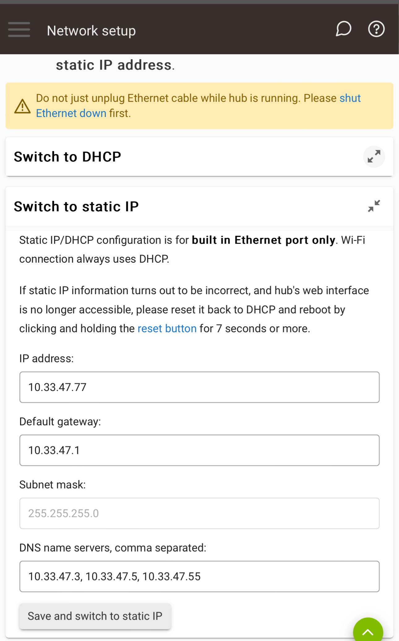

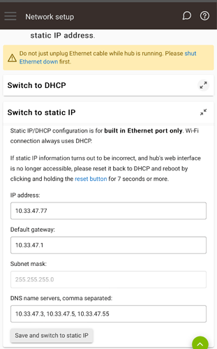

You can manually override DNS, but not via DHCP.
Screenshot 2023-09-20 at 11.15.35 PM
DNS servers assigned by the DHCP server were not used to “dial out”.
The hub negates these and issues a request on port 53 outside of these IPs. I have a crude firewall that blocks everything 53 except a handful of IPs.
I can replicate this at any time. I set the hub on an ip in the blocked 53 range, it will not use the LAN DNS.
