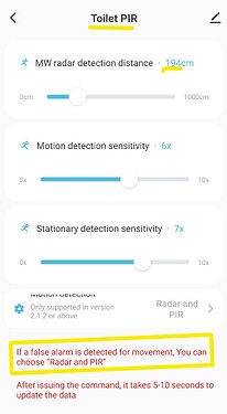

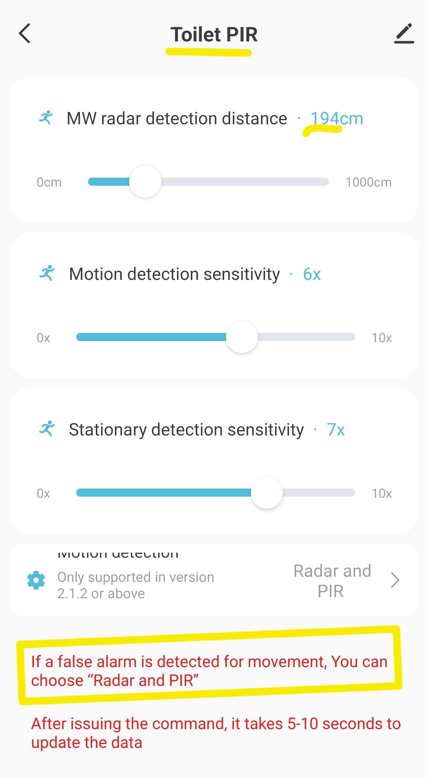

Probably best to include a screenshot of your preferences section and confirm distance.
I am using a few of these sensors and they are working pretty good for me.
But currently using via the Tuya hub so that the sensors can be exposed via Matter to various hubs.

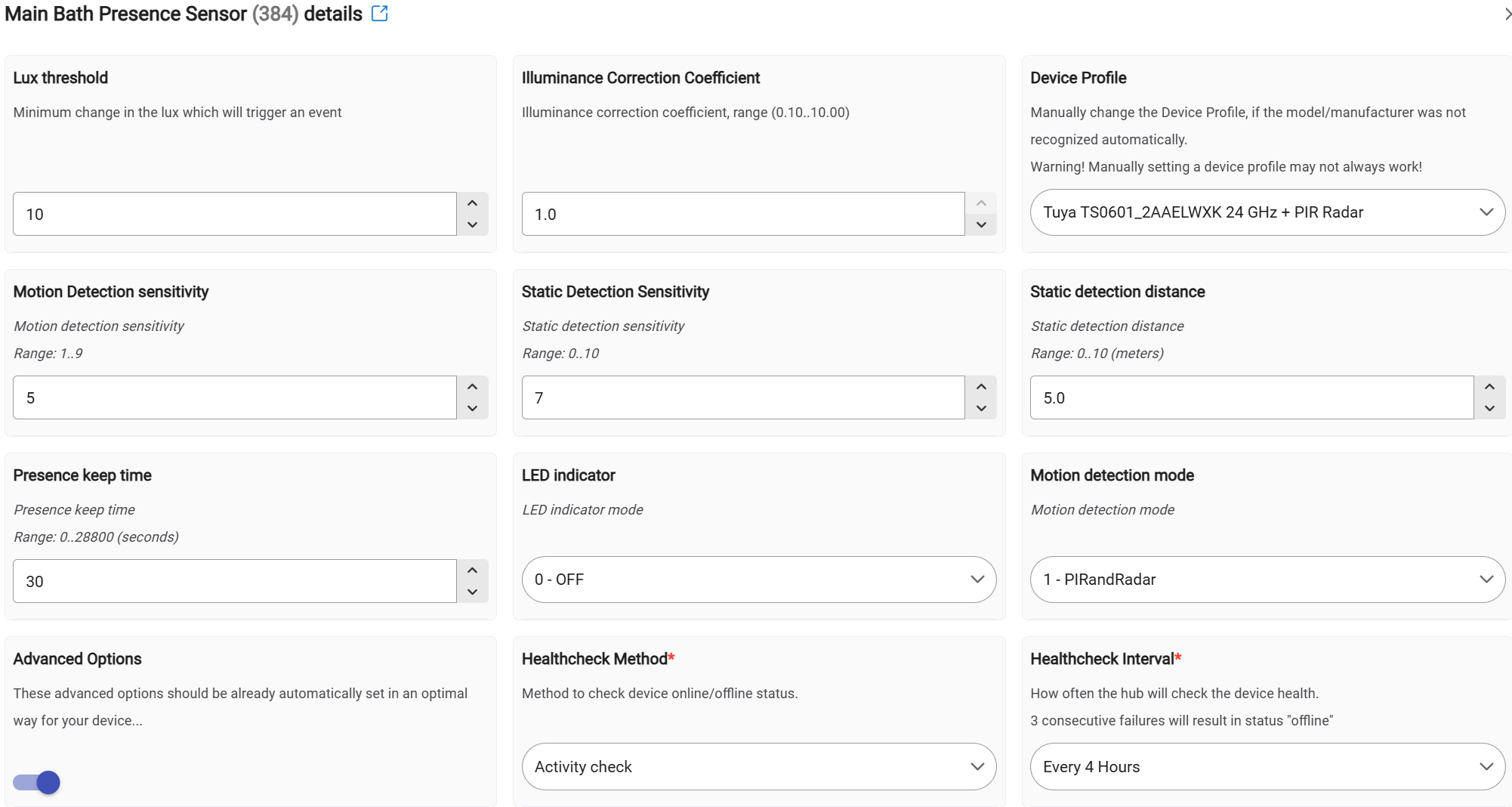

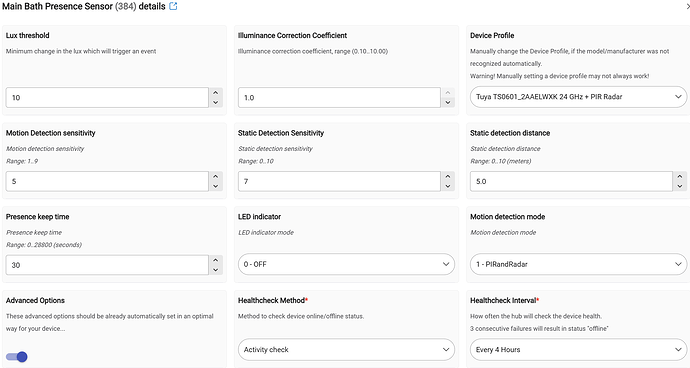

Oops. I thought I did that. Added to post. I kept them at the default.

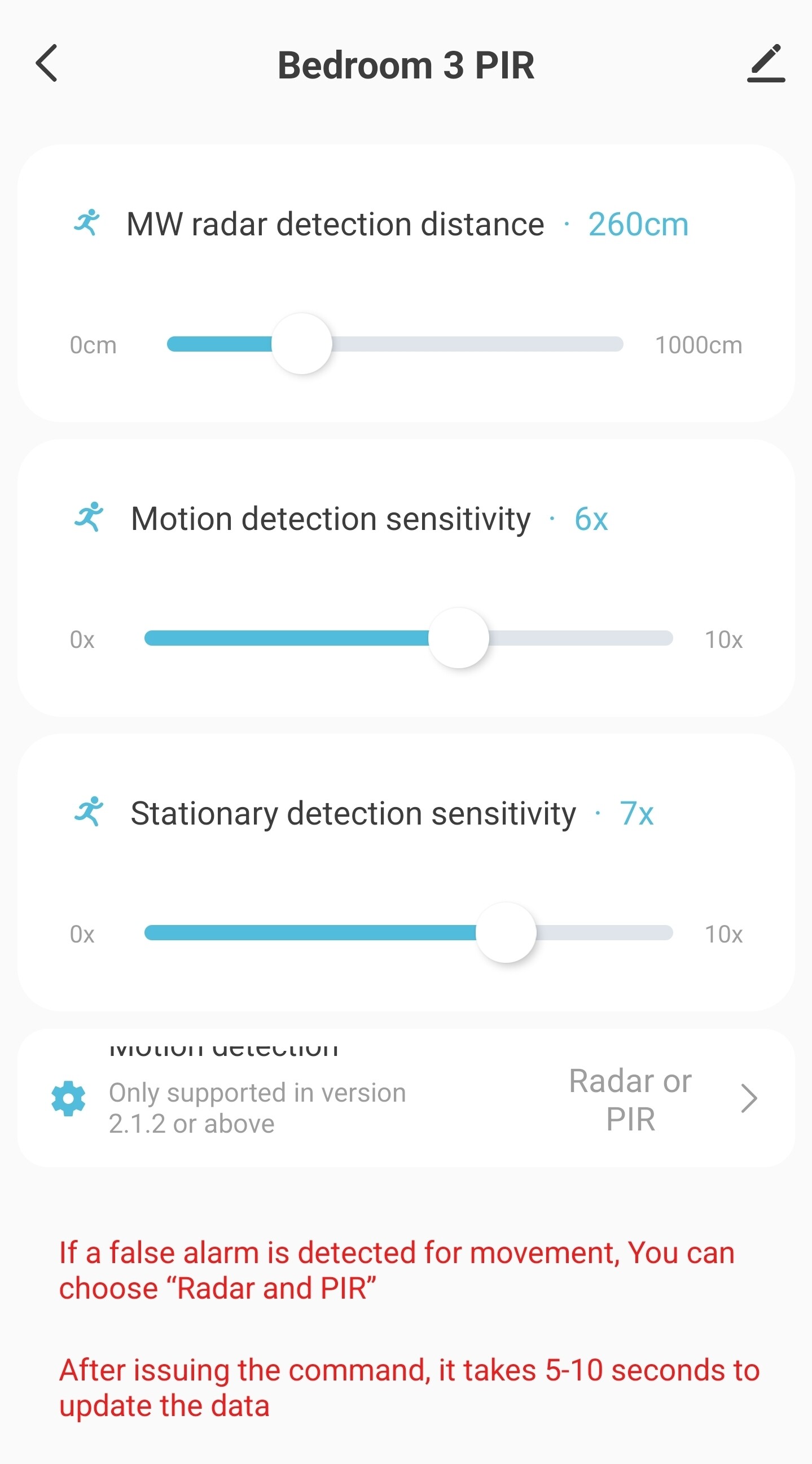

Motion Detection sensitivity: 5m
Static Detection sensitivity: 7
Static Detection distance: 5m
Motion Detection Mode: PIR & Radar
Nothing really jumps out... apart from the static detection distance of 5m ... is this accurate measurement from your sensor to the end of your bathroom ?

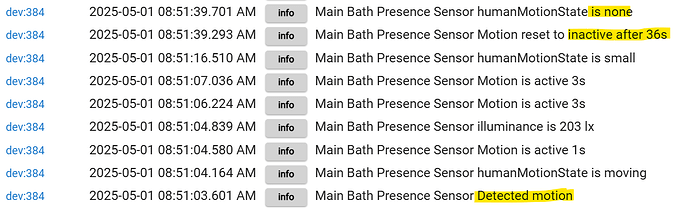

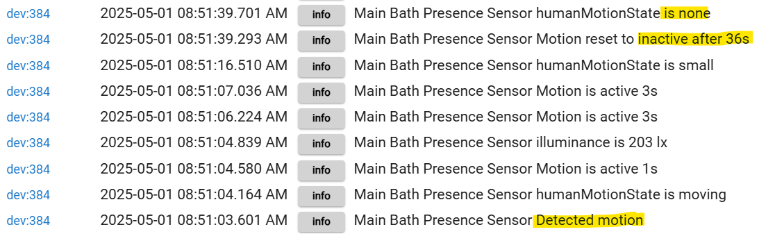

I just find it odd that the "presence timer" when I walk-in and immediately out of the room actually follows the "Presence keep time", but when I do things in the room, it doesn't.
Here's me going in and out of the room immediately:

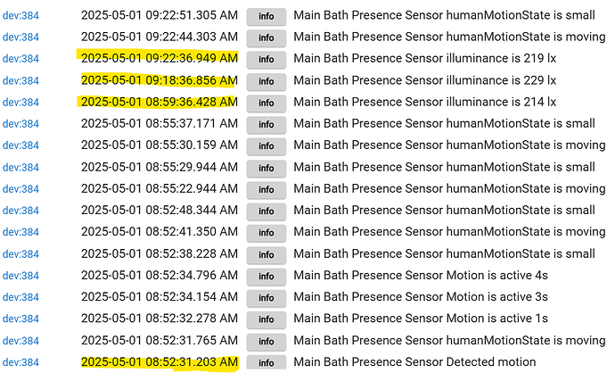

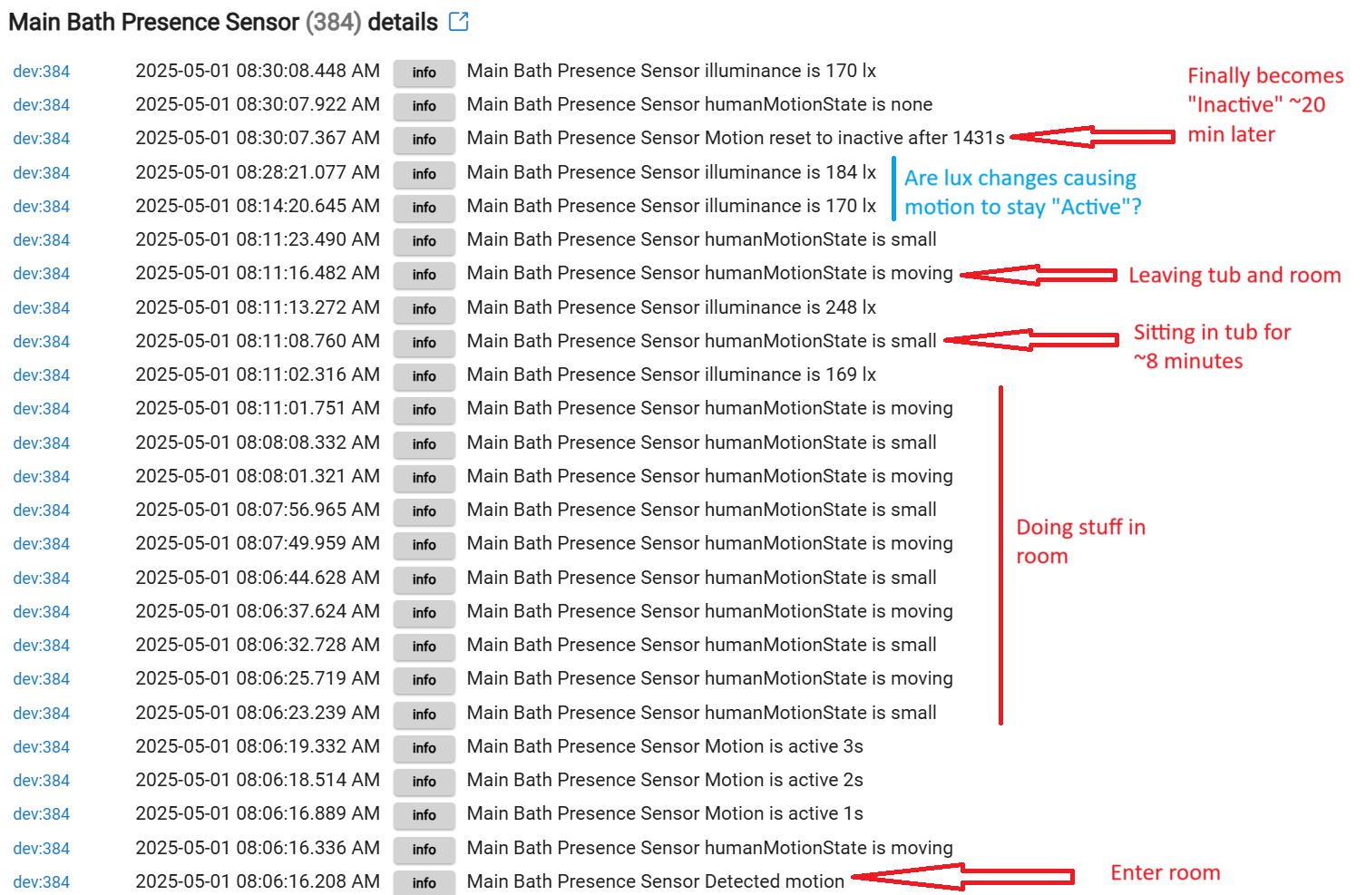

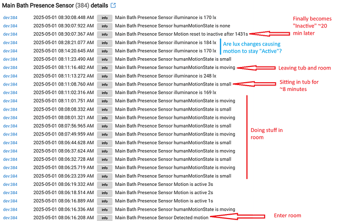

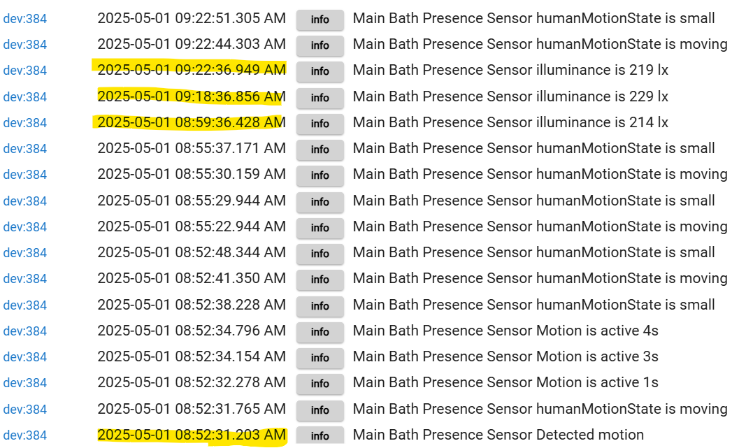

But, if I do things in the room for a bit and sit in the tub for a few minutes, then leave, the "Presence keep time" is almost indefinite. It took such a long time, my husband eventually retriggered sensor -sigh-:
The 9:22 AM is my husband retriggering it. But, I would have expected it to go back to Inactive around 9 AM anyway... I want to blame the lux changes, but there's quite a considerable amount of time between them that it SHOULD have went Inactive in between (8:59 & 9:18).

The only variables to change with these sensors are the sensitivity and distance, and ensure a good line of sight.
Let me try measuring now and adjusting, if needed. I kept it all default to start.
Sure, but distance always needs to be adjusted to your actual measurement range... otherwise it wild detect outside your actual detection zone!
Right. But no one was upstairs when it was doing that odd behavior. We were all downstairs on a work call. It wasn't until 9:22 that my husband triggered it. It should have became Inactive way before then.
I get that, but these sensors are very sensitive and see see through walls as well.

It can go through 2 walls and subfloor with metal vents? That's crazy haha. It may be the sensitivity. I recall complaining about this before and looking at a comment I did, it seems to have fixed it when I changed the sensitivity from 8 to 6. Maybe it was in fact catching minimal lux changes. This is at 7 currently, so I'll try lowering that as much as I can while still being able to detect sitting in the tub. Testing the distance at 4m right now.
Edit: As I am sitting here, it is totally possible it’s grabbing the shadows of the leaves through the window but doesn’t explain why going in and immediately out of the room works fine. I would have expected it to keep that active for that too.
I dropped down the distance but that made it so it wouldn’t detect me sitting in the tub anymore. When I stand up from the tub, I’ll see a “moving” motion so I think the distance is fine. I increased the sensitivity to 8. That made it so it detected “small” motion in the tub. But, now I’m back to the same issue of it being stuck in “small” motion indefinitely.
Okay. The sweet spot seems to be 5m distance (it’s actually not 5m), but changed the sensitivity to 6. I’m guessing 7 was too sensitive and picking up subtle movements from the outside and shadows made by swaying leaves going through the window and skylight.
