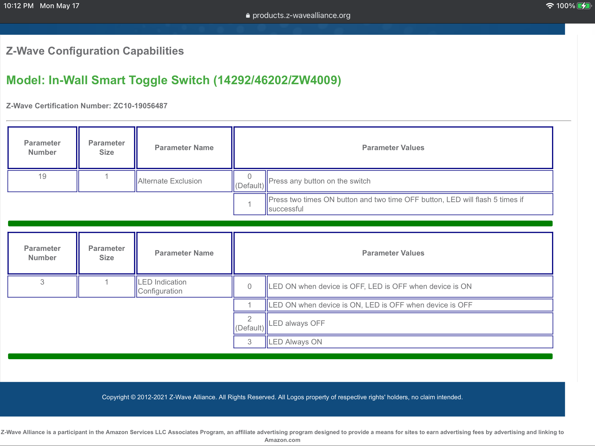

Can also use the Basic Zwave Tool driver to set parameter 3:

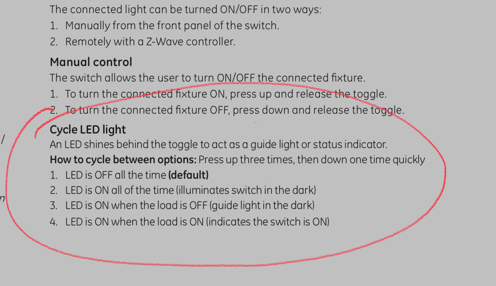

So to cycle thru its 3 up 1 down each time you want to move down the chart. For example if its on #1 and I want to be on #4 have to do the 3 up 1 down 3 times.
