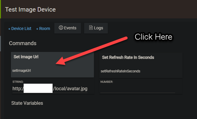

You need to create Virtual Image device, load the url and refresh rate on it, and then use an Image Tile in the Easy Dash.
Is there a link that explains how to load the url to a Virtual Image device?
Don’t recall seeing one, but the device has two commands - one for loading the URL and one for the refresh rate, so pretty straight forward.
Seemed that way, but every time I enter the url, then save, the url disappears...
Do you mean "Save Preferences"? This is not a preference setting, the URL you are entering is a parameter to the Set Image URL command, you need to click the command once you have entered the URL string.
Thank you!! I did not know about clicking the same rectangle into which I enter the data.
That worked!!
