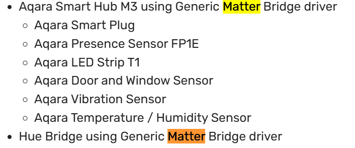

Correct. Though there is some support for bringing devices from Tuya and other hubs that support Matter into HE.
One community example:
And in a recent release HE now directly supports integrating Matter bridges & their devices:
