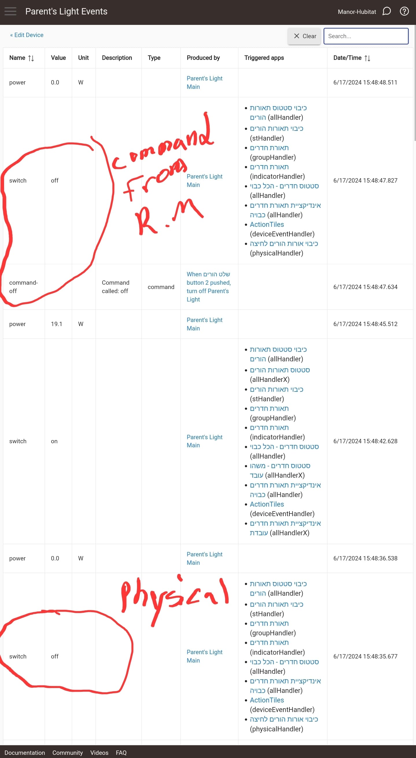

Hi,
I am using "generic component switch" driver (cause this is child device).
Please see attached event screenshot.
Thanks.

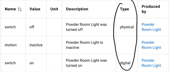

It looks as though the driver doesn't support it as it would show 'physical' and 'digital' alongside those events.
@johnwill1 is correct your switch and driver must support detecting physical events. Not all switches do unfortunately. Here is an example of a GE Zwave switch that turned on via motion and off by me pushing button. The type column is populated with digital vs physical
The Fibaro Double Smart FGS-224 and Double Switch 2 FGS-223 both use the 'Generic Component Switch' child device which doesn't support it and neither does the parent device driver (I have both devices on my system)
