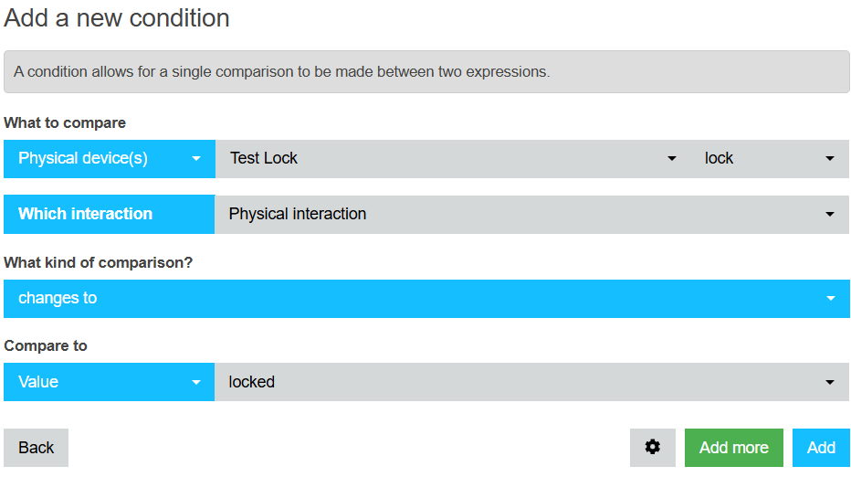

Hi, I tried to do something with the "physical" event in this case from a lock as the trigger but noticed it was not possible (at least not obviously). Could we add physical event filter to the custom attribute please? maybe just a toggle to be able to turn it on for the event please?
I'm surprised that is not possible in RM, I don't see that option either. I would just use Webcore, however, where this option is available.

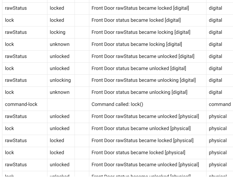

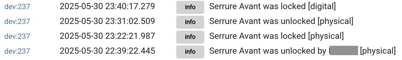

I could be wrong, but I don't think that locks report 'physical' vs 'digital'. If you have one that does, please show the logs that reflect that. It would show in the Type column of the device events.
Separately, why are you needing Custom Attribute for a lock?

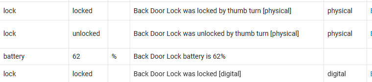

My Alfred DB2-B does show digital and physical events.
But I don’t know why one would need that either ![]()

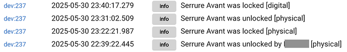

The built-in driver for the Alfred lock does (I have model DB1-C, which is Z-Wave and Bluetooth). The lock reports [physical] for anything done on the lock itself and [digital] when locked/unlocked via HE or Bluetooth (with Alfred's phone app). Quite useful.

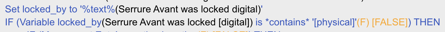

As a workaround I just set a variable to %text% and search the string for either digital or physical in the rule actions.
Yes I have a matter lock via thread. It's a nuki lock, I'll add the image when I'm on laptop.
