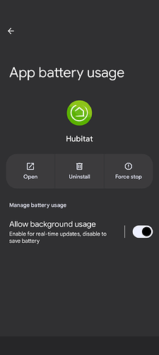

There are additional battery permissions that can be accessed by clicking on the words "Allow Background Usage" in the image above.

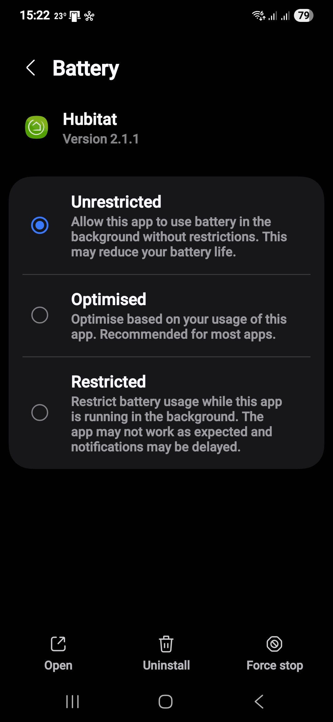

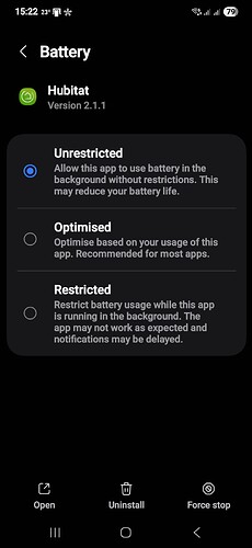

I have been using "unrestricted" with good results.

My Android app presence was spotty on Android 15 (on both a Pixel 8 Pro and Pixel 7a), until I realize I still had them set at the default Optimized. Since I moved them to Unrestricted, our phones have been incredibly reliable in sending geofence updates. So it's important to both "Allow background usage" and set it to Unrestricted.

It depends on the version of Android that you have. In recent versions you only see one option "Allow Background Usage" when you open the battery permissions. In addition to turning on the switch, actually clicking on the words opens up additional options including "Allow Unrestricted".
In your case you already have the Unrestricted option available, without needing to go through the intermediate options.

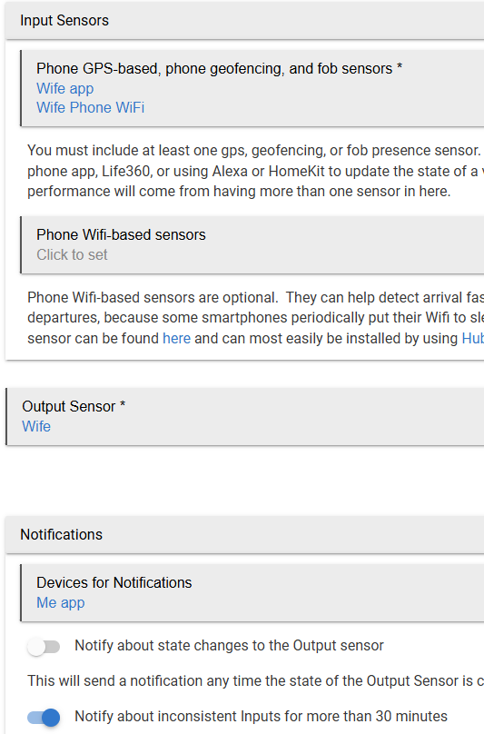

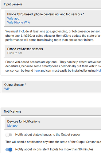

[RELEASE] Combined Presence lets me use multiple different presence sensors to drive a single virtual presence sensor. E.g., this is the settings for my wife (names changed to protect the WAF):
(Note that the Combined Presence instructions say to list the WiFi Presence devices in the 2nd group, as they don't work reliably on iPhones. However, they work very reliably on Android, so I move them up to the first group)
With this setup, our computed presence ("Wife" in this case) works reliably. The bottom check box gives me a notification if the inputs are out of sync, which happens every so often because the app presense has not updated.
