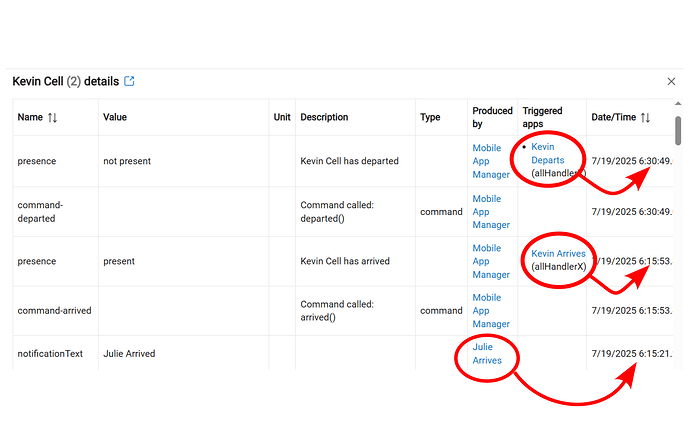

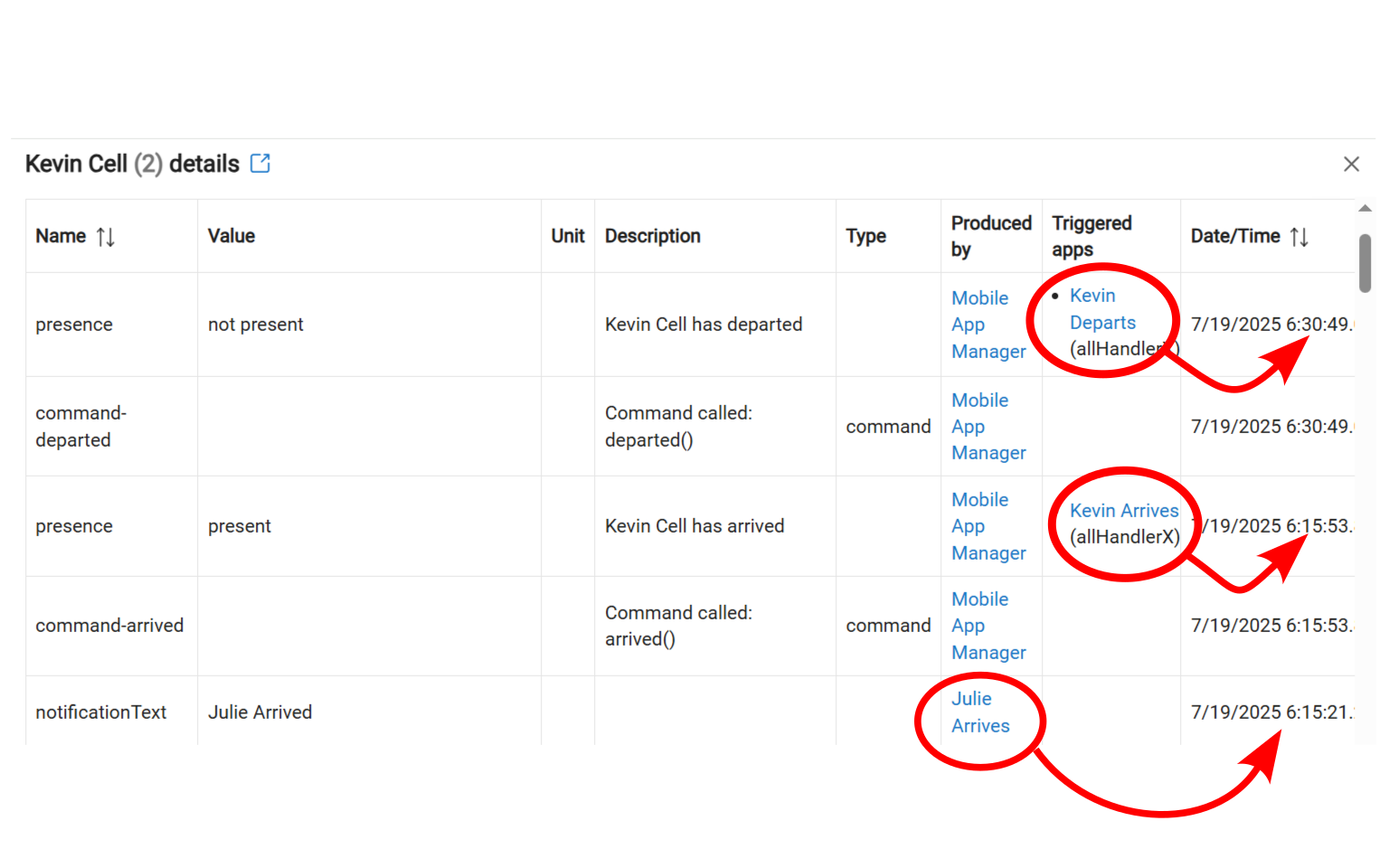

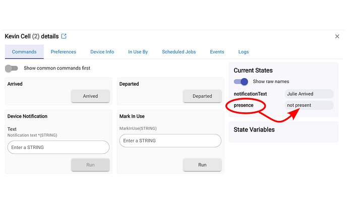

This evening I returned home at 6:15, presence detected, all good. At 6:30 Hubitat thinks I departed. (I didn't - Still here!!)

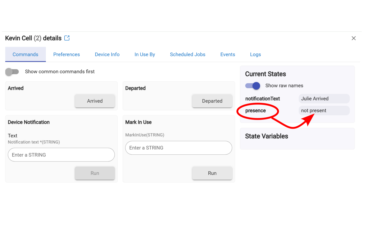

Details shows not present - (still here)

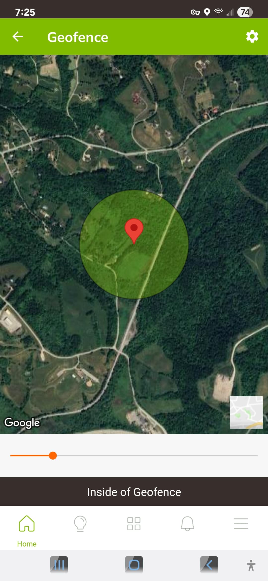

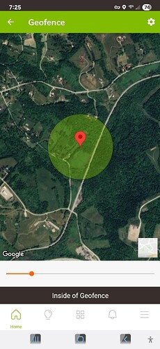

Mobile App shows inside of Geofence.
Where could the disconnect be?

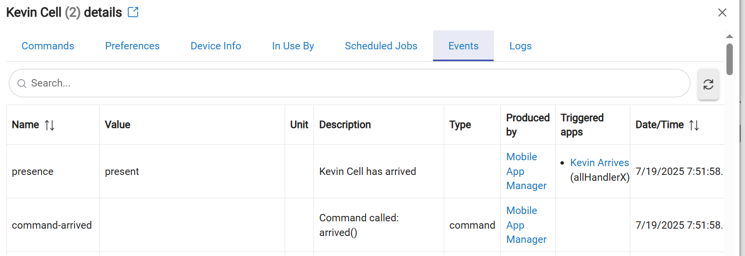

EDIT: 7:51 Present AGAIN! -- Been in the same spot...

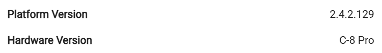

C8 / 2.4.2.131 - Samsung S22+
