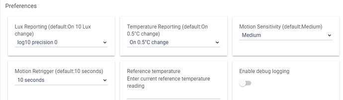

Temperature reporting interval on the driver goes down to 5 minutes.
I changed it to 5 minutes, and lux reporting interval also goes to 5 minutes.
I don't understand the log precision choices. That's for bigger changes, no?
The choices go down to 1 lux...that's pretty sensitive.
Interesting on the temp reporting affecting the lux reporting time. I'll have to try that :smile:
You can think of the log precision as lux "changes by % of current value" - the more precision, the smaller the %. If you used 1 lux in a generally bright room, the sensor will always report a change (ie. 2073 becomes 2081) - if you think, only tell me if it changes 10%. Then it wouldn't. But would still capture lux changing from 10 to 9.

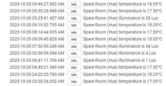

Stranger still, it used to be every 5 minutes. No idea when that changed. I have only every used temp changes, not a time interval.
Last night, when I experimented with 5 minutes setting on temp change causing the lux to report at 5 minute intervals, I couldn't get it back to reporting lux at 10 minute intervals, lol. It sorted itself out overnight. Sometimes I think most Zigbee devices have a mind of their own. :slight_smile:
I can at least confirm that setting the temp setting to 5 minutes brought the lux update back to 5 minutes. Something is not right. I started looking at it myself as I use it for lux readings. For some reason it is not updating lux while it was active.

For some reason now it's pretty much working as I want it too - with a caveat or two.
But having changed it to the Temp Report every 5 minutes, and then back to a more useful (for me) Report on 0.5C change, I get reports every 5 mins from both the illuminance and temperature sensors if there's been a change - which is perfect for me..
