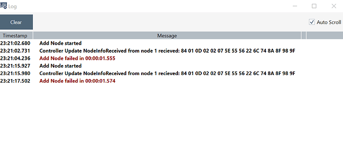

I'm not sure if this is related, but I just tried adding a node using my secondary UZB with PC Controller, for the first time since the update to 2.2.5 on my C7 hub, and it no longer works.
I've had a handful of Inovelli LZW42 bulbs, which of course pair with S0 by default. A month or so ago I removed and re-paired all but one of them using PC Controller, to get them paired without security. This went quite smoothly.

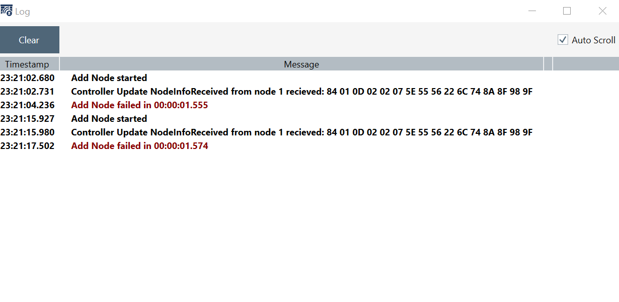

I finally went to convert the last bulb today, but when I tell PC Controller to "Add", it briefly says "Add Node Started", then almost immediately fails with the following message:
which looks like it's based on receiving a message from HE.
Any ideas whether this is due to a change in the HE firmware (@bcopeland perhaps)? I'm running 2.2.5.130, to be specific...
