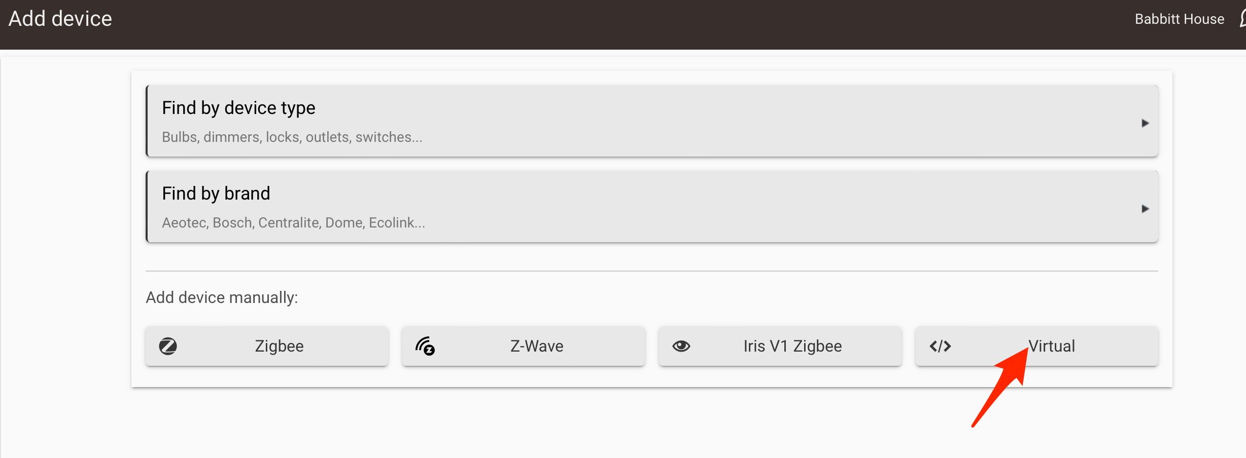

However, I think there's probably a more elegant way of doing this, either with a virtual switch, a presence sensor, a mode change, or something else. As an added benefit there may be other actions you want to have take place when you leave, like turning on or off certain lights, locking doors, setting alarms, and so on.
Once you've created it you can place it on a dashboard and edit your rule to include a required expression that prevents the rule from running if the switch is on. Or off.
