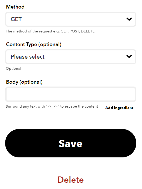

I have an applet in IFTTT setup like this that works with this app.
I blurred out my token and hub id but the app shows you how to get them I think. If it doesn't, the Ring app I wrote shows you how to build the URL.

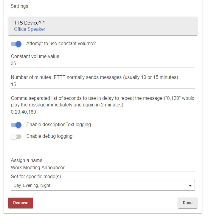

For completeness, the instance of that app looks like this.
Thanks for the examples. This falls into the category of slightly more complex than I am looking to implement at the moment. That said, I don't see why it wouldn't be adaptable to my needs. I was just hoping there was something very simple like an undocumented way of passing data via local end point call.
