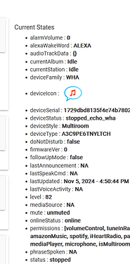

I think you may be missing the obvious - there is a device called WHA created if desired by echo speaks. You send to it and you get audio syncronized on all devices. WHA is 'Whole House Audio' or something like that. Could that solve you?

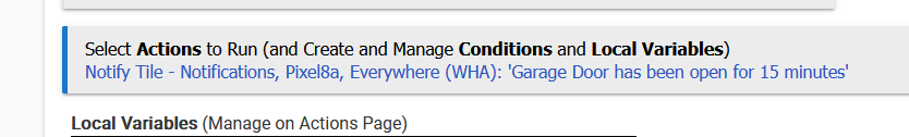

I use it in a number of rules:
WHA is not supported by older Echo devices.

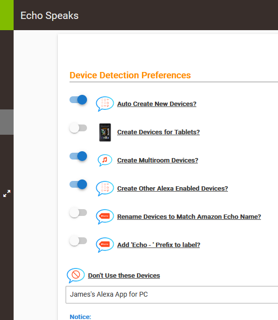

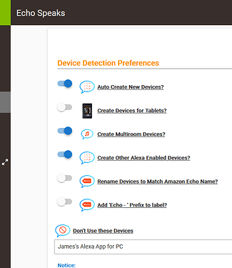

How is the WHA device created?
it has been years since it appeared on my unit - I believe it comes from 'Create Multiroom Devices":
The question is great - I'm really not sure where it comes from! Might have to sift through the Echo Speaks threads from long ago...
Unsure about the post about old units. I've got gen 2, 3, 4 - old echo shows... 5", 8", 10"

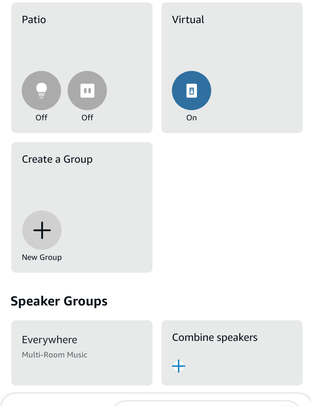

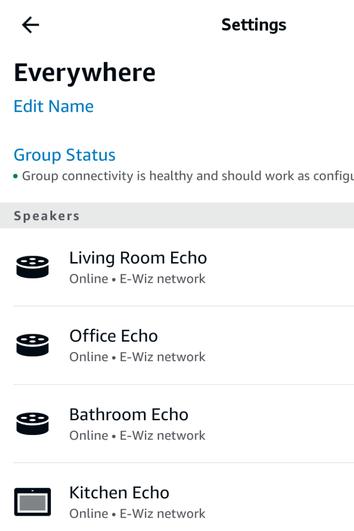

I believe I found the source of 'WHA - Everywhere'. In my Alexa - I have a Speaker Group called 'Everywhere'. At the bottom of 'Groups' on the Alexa app, is 'speaker groups'. I created one for Multi-Room Music. My config looks like this:
Regarding Gen 1, I'm unsure as I don't have that ancient unit, BUT, I did until earlier this year, and it was a part of the Group so I'm believe it did work - my garage unit was an old Gen 1 - but the mic was horrible and the speaker crap!
