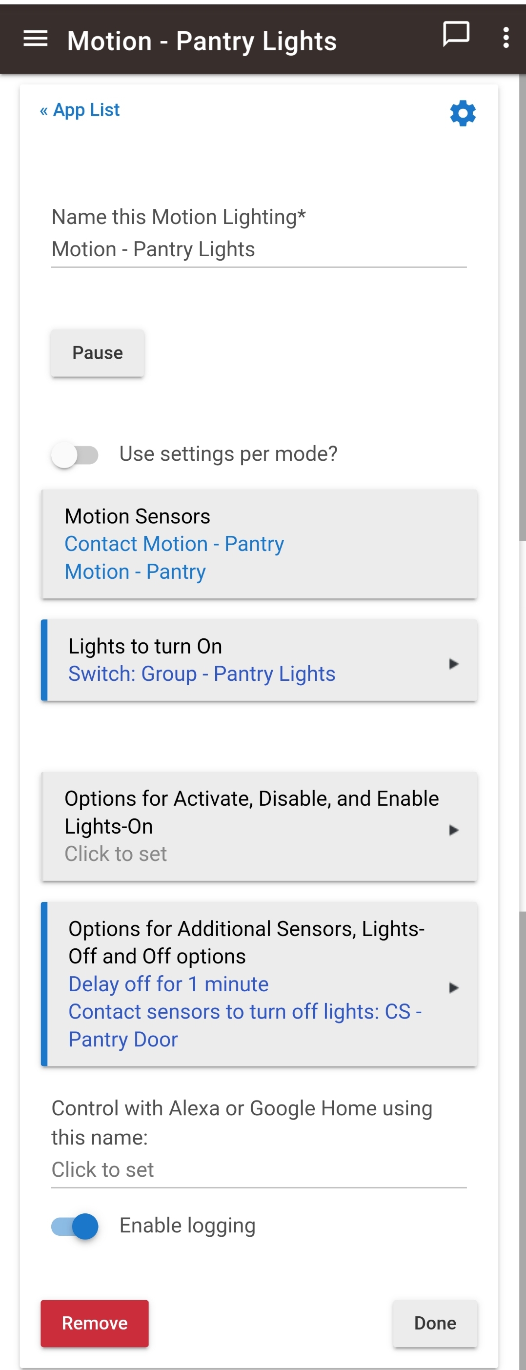

I'm just going to add that KISS is better. If it can be done simply, then it'll run better. Like @Brandon is suggesting motion lighting. Good advice.
Motion Lighting with Bruce's contact as a motion sensor works great for this.

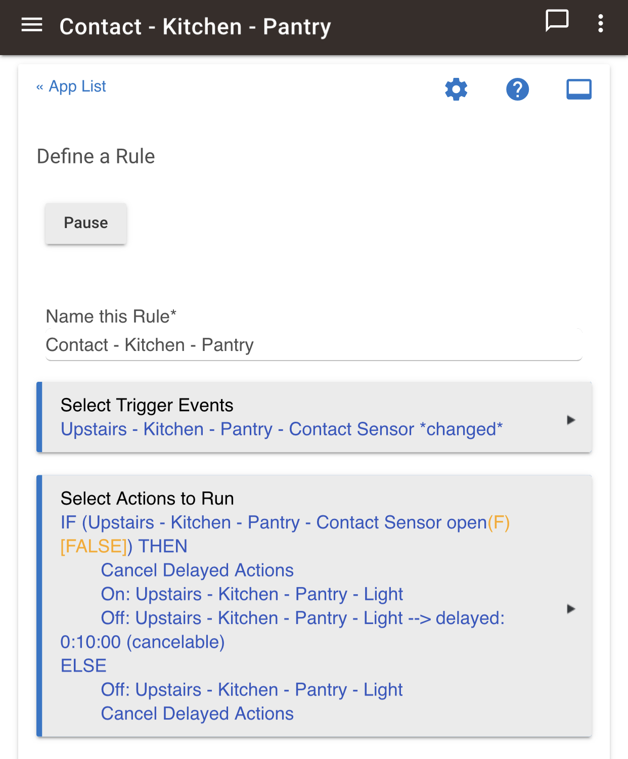

Also here is my rule for completeness.
I’ve got this exact rule written.
Here’s how I do mine:
Edit: this rule has been through a lot of changes and trial/error to see if there were any performance differences. If (when) I write it again, I’d write the actions as:
  1. Cancel delayed actions
  2. If Open
    A. Light: On
    B. Turn off Light > Delayed & Cancelable: N minutes
  3. Else
    A. Turn off light
  4. End If
Thank you for the answers, I ended up doing it with the built in motion lighting app.
